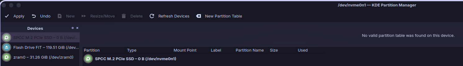

Installer asks what partition I want to use. I select the brand new (and thus empty) M.2 that is, to my knowledge, the only drive connected to the system other than the USB I’m living booting from currently.
I go to click accept and install, wait a couple minutes, and it comes back with the following information:

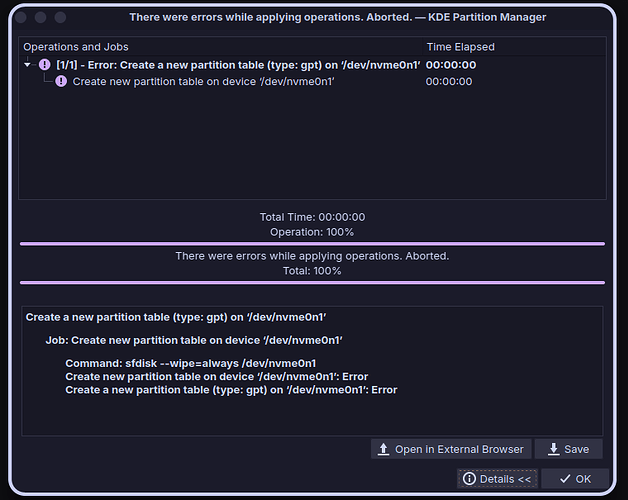

Installation Failed
The installer failed to create a partition table on SPCC M.2 PCIe SSD.
Details:
Create a new partition table (type: gpt) on '/dev/nvme0n1'
Job: Create new partition table on device '/dev/nvme0n1'

Returning to this line of inquiry, I have the results of sudo -E calamares -D8
garuda@garuda-mokka in ~ as 🧙
󰛓 ❯ sudo -E calamares -D8
07:17:58 [6]: Calamares::Settings::Settings(const QString&, bool)
Using Calamares settings file at "/etc/calamares/settings.conf"
.. Required settings.conf key hide-back-and-next-during-exec is missing.
07:17:58 [6]: void Logger::setupLogfile()
Using log file: "/home/garuda/.cache/calamares/session.log"
07:17:58 [6]: void CalamaresApplication::init()
Calamares version: 3.3.14
.. Using Qt version: 6.8.2
.. Build type: Release
.. Using PyBind11
.. Using settings: "/etc/calamares/settings.conf"
.. Using log file: "/home/garuda/.cache/calamares/session.log"
.. Languages: QList("ar", "as", "ast", "az", "az_AZ", "be", "bg", "bn", "ca", "ca@valencia", "cs_CZ", "da", "de", "el", "en", "en_GB", "eo", "es", "es_AR", "es_MX", "et", "eu", "fa", "fi_FI", "fr", "fur", "gl", "he","hi", "hr", "hu", "id", "is", "it_IT", "ja", "ka", "ko", "lt", "ml", "mr", "nb", "nl", "oc", "pl", "pt_BR", "pt_PT", "ro", "ru", "si", "sk", "sl", "sq", "sr", "sr@latin", "sv", "tg", "th", "tr_TR", "uk", "vi", "zh_CN", "zh_TW")
07:17:58 [6]: bool Calamares::initQmlModulesDir()
Using Calamares QML directory "/usr/share/calamares/qml"
07:17:58 [6]: Calamares::Branding::Branding(const QString&, QObject*, qreal)
Using Calamares branding file at "/usr/share/calamares/branding/garuda/branding.desc"
07:17:58 [2]: void Calamares::flavorAndSide(const YAML::Node&, const char*, Branding::PanelFlavor&, Branding::PanelSide&)
WARNING: Branding setting for sidebar is missing, using "widget" "left"
WARNING: Branding setting for navigation is missing, using "widget" "bottom"
07:17:58 [2]: Calamares::Branding::Branding(const QString&, QObject*, qreal)
WARNING: the branding component "/usr/share/calamares/branding/garuda" does not ship translations.
Loaded branding component "garuda"
.. No translation for "tz_" "C" using default (en)
.. No translation for "calamares_" "C" using default (en)
.. STARTUP: initSettings, initQmlPath, initBranding done
.. STARTUP: initModuleManager: module init started
07:17:58 [6]: void Calamares::ModuleManager::doInit()
Found 53 modules
07:17:58 [6]: void CalamaresApplication::initView()
STARTUP: initModuleManager: all modules init done
STARTUP: initJobQueue done
07:17:58 [6]: CalamaresWindow::CalamaresWindow(QWidget*)
Available desktop QSize(3840, 2160) minimum size QSize(1024, 520)
.. Proposed window size: 1024 664
07:17:58 [2]: QString Calamares::_stylesheet(const QDir&)
WARNING: The branding component "/usr/share/calamares/branding/garuda" does not ship stylesheet.qss.
STARTUP: CalamaresWindow created; loadModules started
07:17:58 [6]: void Config::initLanguages()
Trying to match locale "C"
Trying to match locale QLocale(C, Default, Default)
.. Trying to match approximate locale QLocale::C
.. Trying to match English (US)
07:17:58 [6]: void Config::setLocaleIndex(int)
Index 14 Selected locale "en"
.. Loaded QRC translation "tz_" "en"
.. Loaded QRC translation "calamares_" "en"
07:17:58 [8]: INFO (Qt): OpenType support missing for "Inter", script 12
07:17:58 [8]: INFO (Qt): OpenType support missing for "Inter", script 11
07:17:58 [8]: INFO (Qt): OpenType support missing for "Inter", script 19
07:17:58 [8]: INFO (Qt): OpenType support missing for "Inter", script 20
07:17:58 [6]: virtual void Calamares::ViewModule::loadSelf()
ViewModule "welcome@welcome" loading complete.
07:17:58 [6]: QStringList loadLocales(const QString&)
Loading locales from "/usr/share/i18n/SUPPORTED"
..  Read 501 lines
..  After filtering 326 lines
ViewModule "locale@locale" loading complete.
07:17:58 [2]: void Calamares::Module::loadConfigurationFile(const QString&)
WARNING: No config file for "keyboard" found anywhere at
"/etc/calamares/modules/keyboard.conf"
"/usr/share/calamares/modules/keyboard.conf"
07:17:58 [6]: KeyboardModelsModel::KeyboardModelsModel(QObject*)
Loaded 183 keyboard models
07:17:58 [6]: KeyboardGroupsSwitchersModel::KeyboardGroupsSwitchersModel(QObject*)
Loaded 45 keyboard groups
07:17:58 [6]: KeyboardPage::KeyboardPage(Config*, QWidget*)
Variants now total= 0 selected= -1
Groups now total= 45 selected= -1
.. Loaded QRC translation "kb_" "en"
07:17:58 [6]: void Config::getCurrentKeyboardLayoutXkb(QString&, QString&, QString&)
QList("pc", "us", "inet(evdev)", "terminate(ctrl_alt_bksp)\"")
ViewModule "keyboard@keyboard" loading complete.
07:17:58 [6]: Calamares::Partition::InternalManager::InternalManager()
KPMCore backend starting ..
07:17:58 [6]: DEBUG (Qt): Loaded backend plugin:  "pmsfdiskbackendplugin"
.. Backend @0x5f250b43bda0 "pmsfdiskbackendplugin" "1"
07:17:58 [2]: virtual void PartitionViewStep::setConfigurationMap(const QVariantMap&)
WARNING: Partition-module setting *defaultPartitionTableType* is unset, will use gpt for efi or msdos for bios
ViewModule "partition@partition" loading complete.
07:17:58 [2]: bool addPasswordCheck(const QString&, const QVariant&, PasswordCheckList&)
WARNING: nonempty check is ignored; use minLength: 1
ViewModule "users@users" loading complete.
ViewModule "summary@summary" loading complete.
07:17:58 [6]: void Calamares::ModuleManager::loadModules()
Module "partition@partition" already loaded.
07:17:58 [6]: Calamares::SlideshowQML::SlideshowQML(QWidget*)
QML import paths:
"/usr/bin"
"qrc:/qt-project.org/imports"
"qrc:/qt/qml"
"/usr/lib/qt6/qml"
07:17:58 [2]: virtual void MachineIdJob::setConfigurationMap(const QVariantMap&)
WARNING: MachineId: configuration setting *symlink* is deprecated, use *dbus-symlink*.
07:17:58 [6]: virtual void Calamares::CppJobModule::loadSelf()
CppJobModule "machineid@machineid" loading complete.
Module "locale@locale" already loaded.
Module "keyboard@keyboard" already loaded.
07:17:59 [2]: void Calamares::Module::loadConfigurationFile(const QString&)
WARNING: No config file for "luksbootkeyfile" found anywhere at
"/etc/calamares/modules/luksbootkeyfile.conf"
"/usr/share/calamares/modules/luksbootkeyfile.conf"
07:17:59 [6]: virtual void Calamares::CppJobModule::loadSelf()
CppJobModule "luksbootkeyfile@luksbootkeyfile" loading complete.
WARNING: No config file for "fstab" found anywhere at
"/etc/calamares/modules/fstab.conf"
"/usr/share/calamares/modules/fstab.conf"
CppJobModule "dracutlukscfg@dracutlukscfg" loading complete.
07:17:59 [6]: void Calamares::ModuleManager::loadModules()
Module "users@users" already loaded.
WARNING: No config file for "grubcfg" found anywhere at
"/etc/calamares/modules/grubcfg.conf"
"/usr/share/calamares/modules/grubcfg.conf"
WARNING: No config file for "postcfg" found anywhere at
"/etc/calamares/modules/postcfg.conf"
"/usr/share/calamares/modules/postcfg.conf"
WARNING: No config file for "umount" found anywhere at
"/etc/calamares/modules/umount.conf"
"/usr/share/calamares/modules/umount.conf"
CppJobModule "umount@umount" loading complete.
07:17:59 [2]: void Config::setConfigurationMap(const QVariantMap&)
WARNING: Configuring the finished module with deprecated restartNowEnabled settings
07:17:59 [6]: virtual void Calamares::ViewModule::loadSelf()
ViewModule "finished@finished" loading complete.
07:17:59 [6]: setGeoIP(Config*, const QVariantMap&)::<lambda()>
GeoIP result for welcome= "US"
07:17:59 [6]: void setCountry(Config*, const QString&, Calamares::GeoIP::Handler*)
Unusable country code "US"
.. Obtained from "https://ipapi.co/json"  ( 1 "country" )
07:17:59 [6]: void CalamaresApplication::initViewSteps()
STARTUP: loadModules for all modules done
07:17:59 [6]: void Calamares::ModuleManager::checkRequirements()
Checking module requirements ..
STARTUP: Window now visible and ProgressTreeView populated
.. 8 view steps loaded.
07:17:59 [6]: void applyXkb(const BasicLayoutInfo&, AdditionalLayoutInfo&)
xkbmap selection changed to:  "us" - ""
07:17:59 [6]: DEBUG (Qt): getting temp failed for  "/dev/nvme0n1" :  No such file or directory
07:17:59 [6]: DEBUG (Qt): getting powered on time failed for  "/dev/nvme0n1" :  No such file or directory
07:17:59 [6]: DEBUG (Qt): getting power cycles failed for  "/dev/nvme0n1" :  No such file or directory
07:17:59 [2]: WARNING (Qt): unknown file system type  ""  on  "/dev/nvme0n1p2"
07:17:59 [6]: DEBUG (Qt): smartctl initialization failed for  "/dev/sda" :  No such file or directory
07:17:59 [6]: DEBUG (Qt): error during smart output parsing for  "/dev/sda" :  No such file or directory
07:17:59 [2]: WARNING (Qt): unknown file system type  "dos"  on  "/dev/sda"
07:17:59 [6]: DEBUG (Qt): smartctl initialization failed for  "/dev/zram0" :  No such file or directory
07:17:59 [6]: DEBUG (Qt): error during smart output parsing for  "/dev/zram0" :  No such file or directory
07:17:59 [6]: QList<Device*> PartUtils::getDevices(DeviceType)
Removing unsuitable devices: 3 candidates.
.. Running QList("blkid", "/dev/nvme0n1")
.. Running QList("blkid", "")
.. Target cmd: QList("blkid", "") Exit code: 2 (no output)
.. Running QList("blkid", "/dev/nvme0n1p1")
.. Running QList("blkid", "/dev/nvme0n1p2")
.. Running QList("blkid", "/dev/sda")
.. Running QList("blkid", "/dev/sda1")
.. Running QList("blkid", "/dev/sda2")
.. Removing device with iso9660 filesystem (probably a CD) on it "/dev/sda"
.. Removing zram "/dev/zram0"
.. there are 1 devices left.
07:17:59 [6]: void PartitionCoreModule::doInit()
LIST OF DETECTED DEVICES:
.. node     capacity        name    prettyName
.. "/dev/nvme0n1" 2048408248320 DevName$80caecc7 DevNamePretty$8764d89d
.. 1 devices detected.
07:17:59 [6]: Calamares::RequirementsList GeneralRequirements::checkRequirements()
GeneralRequirements output:
storage :   32104880537
enoughStorage :   true
RAM :   2684354560
enoughRam :   true
hasPower :   true
hasInternet :   true
isRoot :   true
07:17:59 [6]: void Calamares::RequirementsChecker::addCheckedRequirements(Calamares::Module*)
Got 5 requirement results from "welcome"
07:18:00 [6]: void Calamares::RequirementsChecker::reportProgress()
Remaining modules: 1
"partition"
07:18:01 [6]: OsproberEntryList PartUtils::runOsprober(DeviceModel*)
os-prober gave no output.
07:18:01 [2]: WARNING (Qt): beginResetModel called on BootLoaderModel(0x5f250b4408c0) without calling endResetModel first
07:18:01 [2]: WARNING (Qt): endResetModel called on BootLoaderModel(0x5f250b4408c0) without calling beginResetModel first
07:18:01 [6]: void PartitionCoreModule::scanForEfiSystemPartitions()
system is EFI and new EFI system partition has been found.
07:18:01 [6]: void Calamares::RequirementsChecker::addCheckedRequirements(Calamares::Module*)
Got 1 requirement results from "partition"
07:18:01 [2]: void ChoicePage::updateActionDescriptionsTr()
WARNING: Invalid osprober count, labels and buttons not updated.
07:18:01 [6]: bool ChoicePage::calculateNextEnabled() const
No partitioning choice has been made yet
07:18:01 [6]: void ChoicePage::updateDeviceStatePreview()
Updating partitioning state widgets.
07:18:01 [6]: void ChoicePage::setupActions()
Setting up actions for "/dev/nvme0n1" with 0 entries.
..  Can not resize "/dev/nvme0n1" , filesystem "unknown" does not support resize.
..  Checking if "/dev/nvme0n1" can be replaced.
..  NO, insufficient storage
Required  storage B: 32641751449 "(29.9GiB)"
Available storage B: 1048576 "(0GiB)"
Required  storage B: 34789235097 "(32.4GiB)"
Available storage B: 314568704 "(0GiB)" for "/dev/nvme0n1p1" length: 614400 sectorsUsed: 8 fsType: "fat32"
..  Checking if "/dev/nvme0n1p1" can be replaced.
Available storage B: 314572800 "(0GiB)"
..  Can not resize "/dev/nvme0n1p2" , filesystem "unknown" does not support resize.
..  Checking if "/dev/nvme0n1p2" can be replaced.
..  Partition "/dev/nvme0n1p2" authorized for replace install.
.. contains replaceable "/dev/nvme0n1p2"
07:18:01 [6]: void ChoicePage::updateActionDescriptionsTr()
Setting texts for 0 osprober entries
No partitions available for resize-action.
07:18:01 [6]: void ChoicePage::continueApplyDeviceChoice()
Previous device -1 new device 0
07:18:01 [6]: void ChoicePage::applyActionChoice(InstallChoice)
InstallChoice Config::NoChoice "none"
07:18:01 [6]: void ChoicePage::updateActionChoicePreview(InstallChoice)
Updating partitioning preview widgets.

Alright, the puzzle becomes…puzzlier?
I open the partition manager to delete all the partitions on the drive.
Aaaaaaaaaaaaaaand it has zero (0) bytes?
So I tried to make a new partition table with the manager just for kicks and sure enough:
Does Not Work:
IDK if that tells y’all anything.
EDIT:
On a reboot, it has decided there is no partitions to install on. Yay…
Starting to suspect I got a bad drive :cry:
