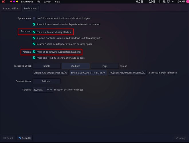

I do have some feedback on the migration.
So before migration Latte handles the key to open the application menu. Currently performing the migration does not unbind Latte from the key, and thus the menu does not open unless I manually restart Latte, right click the dock ~> Configure Latte ~> Uncheck the options binding to the application menu.
Only then can I hit and the application menu be opened from the Plasma Panel (after killing Latte first of course).
Is there anyway to uncheck those settings (Use to open application menu, autostart) as part of the migration?

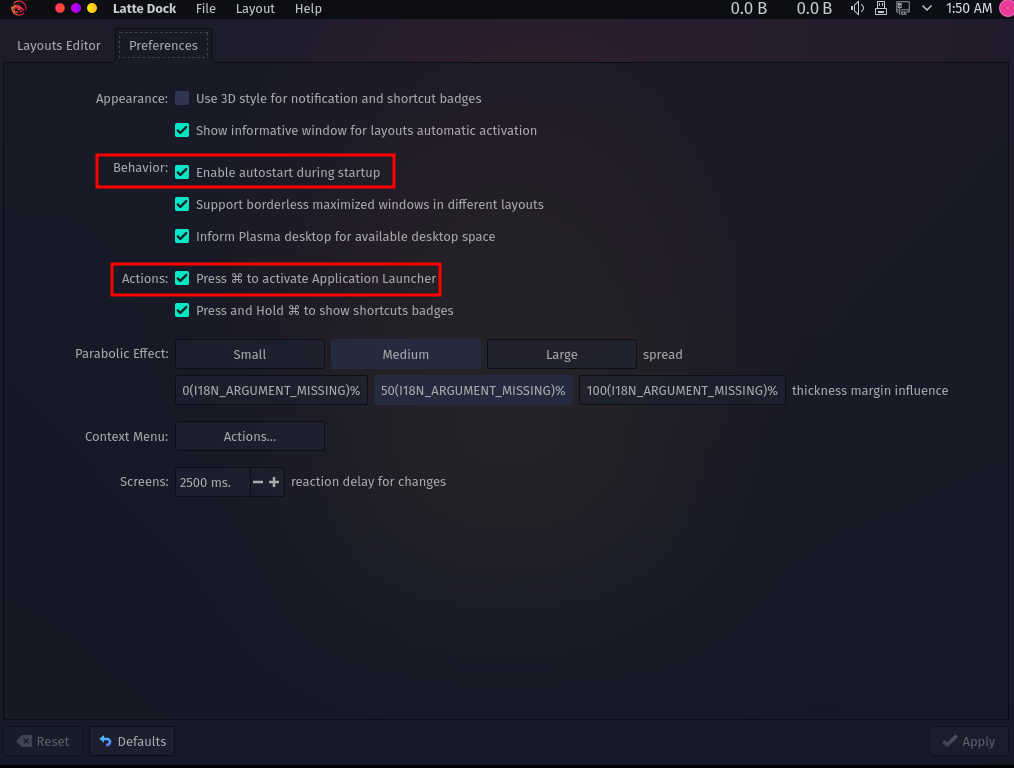

Edit: Sorry, reverting back to get a screenshot of the Latte options as I'm sure that would help.
Edit-2: Here are the options I think need to be disabled. Autostart specifically because the migration didn't remove latte-dock automatically.
As part of the migration, that needs to be checked.

I just tested it with the upgrade to 5.27 and after installing garuda-dr460nized-next and garuda-system-maintenance-git, rebooting and performing the migration from the prompt. All this on a fresh install to make sure no custom settings or configs would interfere with my testing.
After the migration, hitting < super > doesn’t open application menu from the plasma top panel.
It’s not supposed to autostart on next reboots.
It depends exactly which steps you followed to perform the migration. If you did manually, then you have to remove Latte too. If you used garuda-system-maintenance-git (the kdialog prompt), it should not relaunch Latte.
