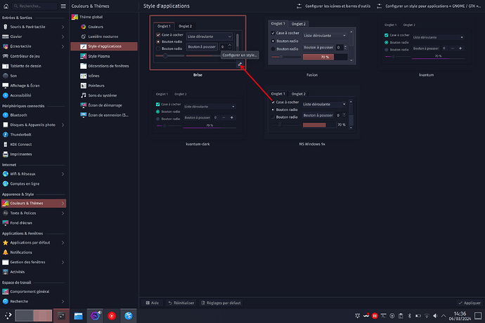

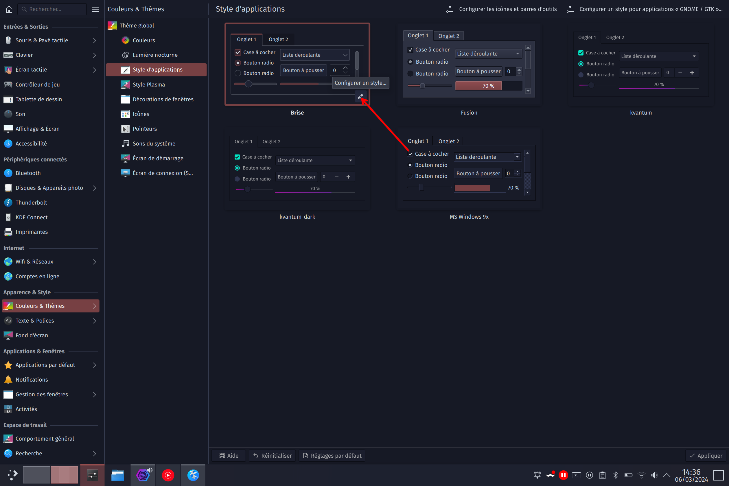

This doesnāt apply the Kvantum theme sadly, switch it via Kvantum Manager manually to Dr460nized. This is an issue because Kvantum isnāt compiled against KDE 6 yet, which means no blur behind windows.
I had the same issue with transparency in Dolphin but I just switched the global theme to Breeze Dark. I am in dolphin almost all the time so I couldnāt use it with the transparency.

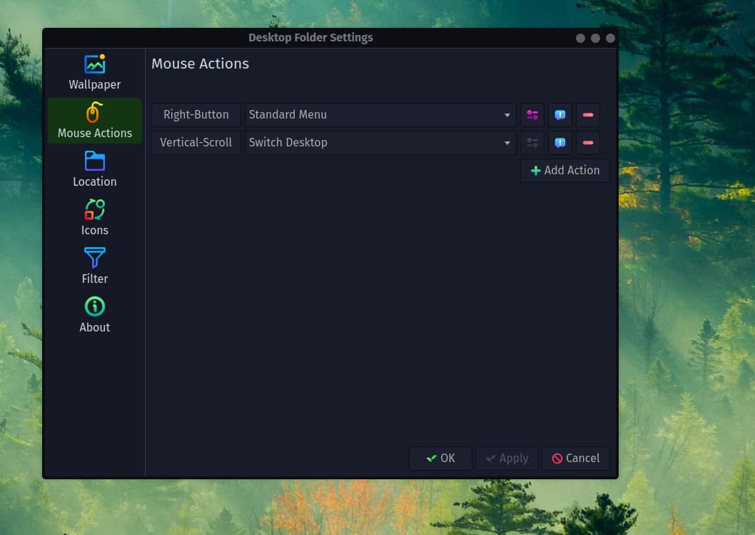

EDIT:
I figured out the workspace switcher, it got disabled by default now

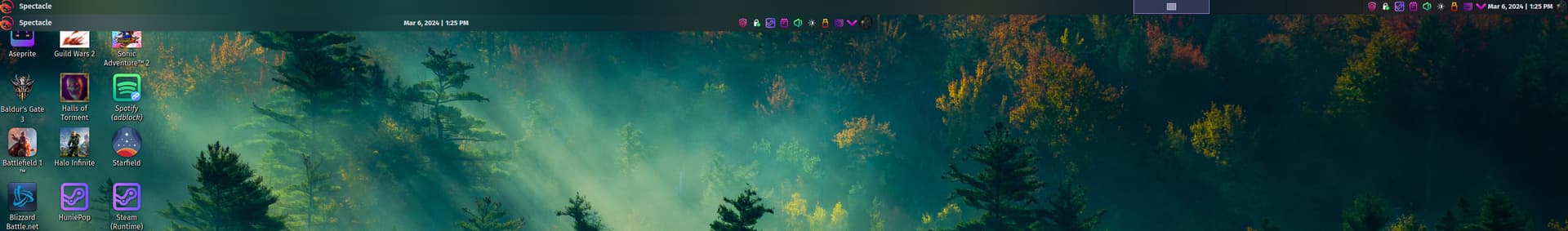

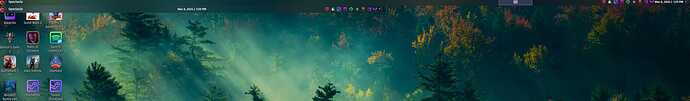

When I said panel layouts I should have said panel locations instead. My top bar panel gets stacked under each other on one monitor instead of being at the top of each monitor.
its a known BUG, i have the same problem as on KDE 5 I had 3 panels next to each other on TOP of the screen.
https://bugs.kde.org/show_bug.cgi?id=477939

Interesting, I did not have this issue on KDE 5 - just today when i upgraded to 6.
I edited my last post and attached a screenshot. Like i said, itās not big deal, i just wanted to report some of my findings. I can live with minor annoyances. Overall im very happy with the upgrade and the work Garuda put in to make it as smooth as possible.
