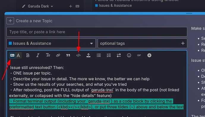

  • Format terminal output (including your garuda-inxi) as a code block by clicking the preformatted text button (</>), or put three tildes (~) above and below the text
Well, 3 tildas did not work then!
I have now used the button - but surely that does not look right! ?
Press the markdown editor mode icon again (upper left corner)
Looks now good :+1:
