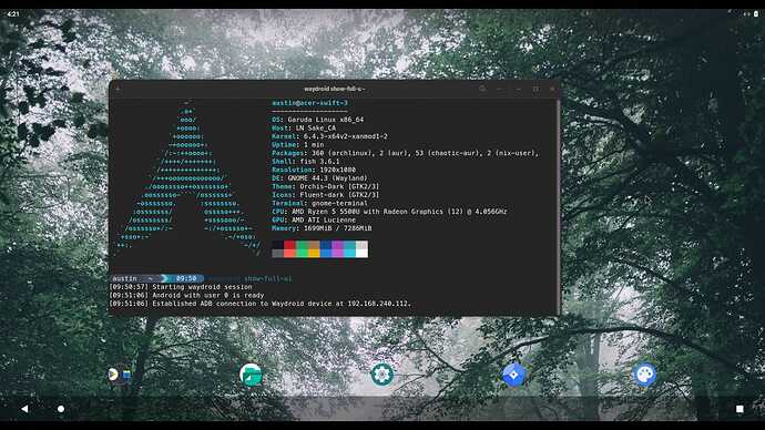

Waydroid works for me with linux-xanmod,
Magisk in Waydroid, weirdly/interestingly, works only with linux-xanmod.
As you can see in the screenshot below, Magisk is installed when using linux-xanmod.
You just have to install Magisk Delta through waydroid-extras, and everything is automatically configured (only with linux-xanmod).

Now i can finally run waydroid properly also i have root access now thanks to Austin
