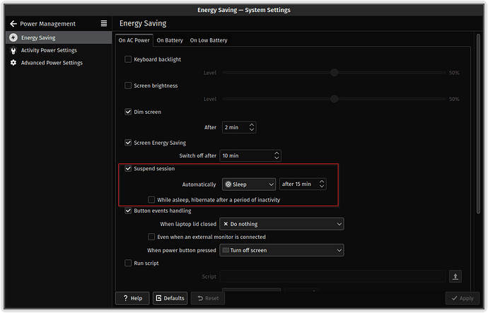

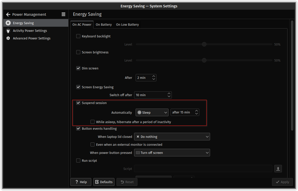

I had a similar problem in the beginning when i installed Garuda. The laptop went sleep or not but never i cant wake it up.
I changed the setting in the “Power management ==> energy saving ==> suspend session” from " Hybrid Sleep" to " Sleep"

Thanks! Unfortunately it was already on “Suspend” and also trying “Hybrid suspend” did not change anything in my case, it didn’t even sleep at all.
