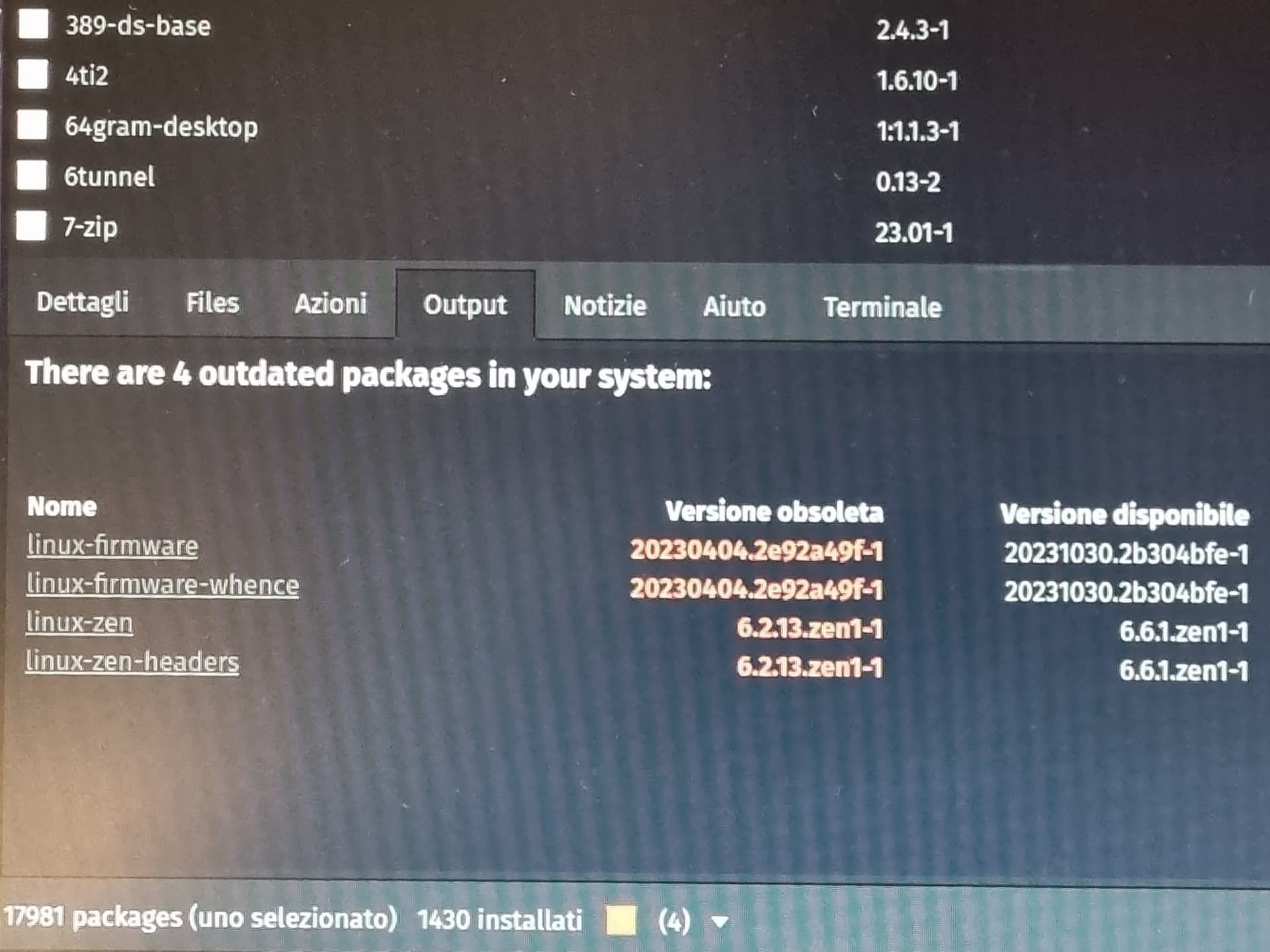

…but Octopi in live usb said at startup that “Pacman Database is missing” and do not show anything. :disappointed:

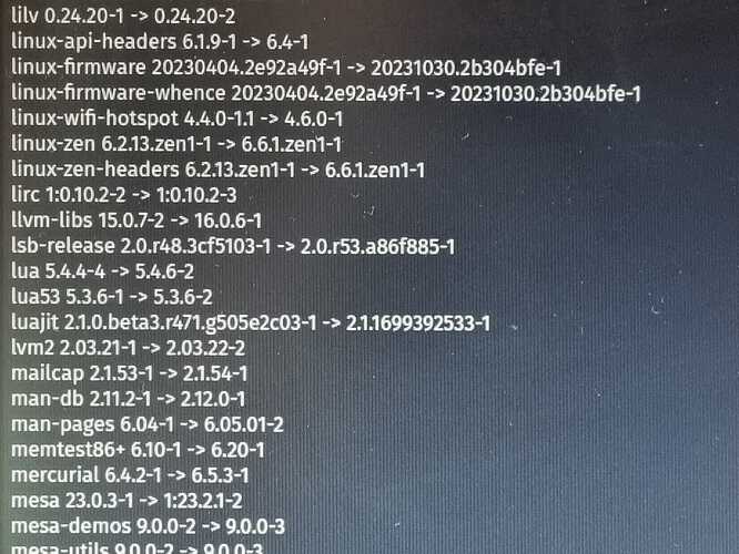

Tried to check updates and this showed up:
I take the entry on the left is the actual live usb packet and the one on the right is the proposed update?
I downgraded both linux-firmware, linux-Firmware-whence, linux-kernel and linux-kernel-headers via the command “downgrade”:
