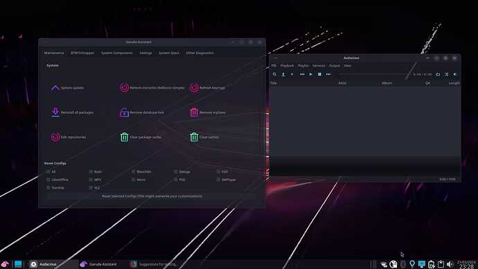

Something has broken the theming of Garuda utilities such as Garuda Assistant. Other KDE software such as Audacious was not effected and theme correctly.
I restored my OS to its previous state using snapper and the Garuda theming works without issue. The Kvantum settings are unchanged before and after the update.
Does anyone know which of the updates could be causing the issue? Maybe qt6?

The problem I’m having is at least one of packages in the aforementioned update breaks the color theming of Garuda items such as Garuda Assistant etc, but it doesn’t break the theming of KDE software such as Audacious, and this is quite baffling. I am wondering if anyone knows which update is causing the issue.

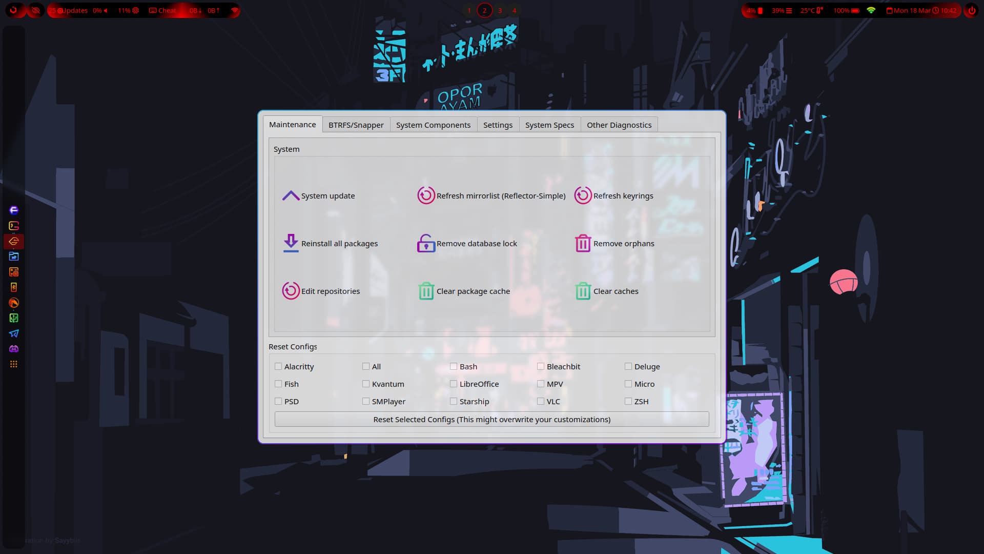

I found I had the same problem in getting KDE to theme properly as were mentioned in this thread:
I installed the old Kvantum version because I knew it worked on my other laptop - sudo pacman -S kvantum-qt5 - but when I tried to get it working on my Lenovo laptop it just refused to work. In the end I installed the latest Kvantum version alongside the old one and things magically worked. This was added to the guide…
To get a dark theme on KDE software I found two versions of Kvantum had to be downloaded. Open up the terminal and enter the following to download the required files:
Hopefully it works correctly on all setups.
