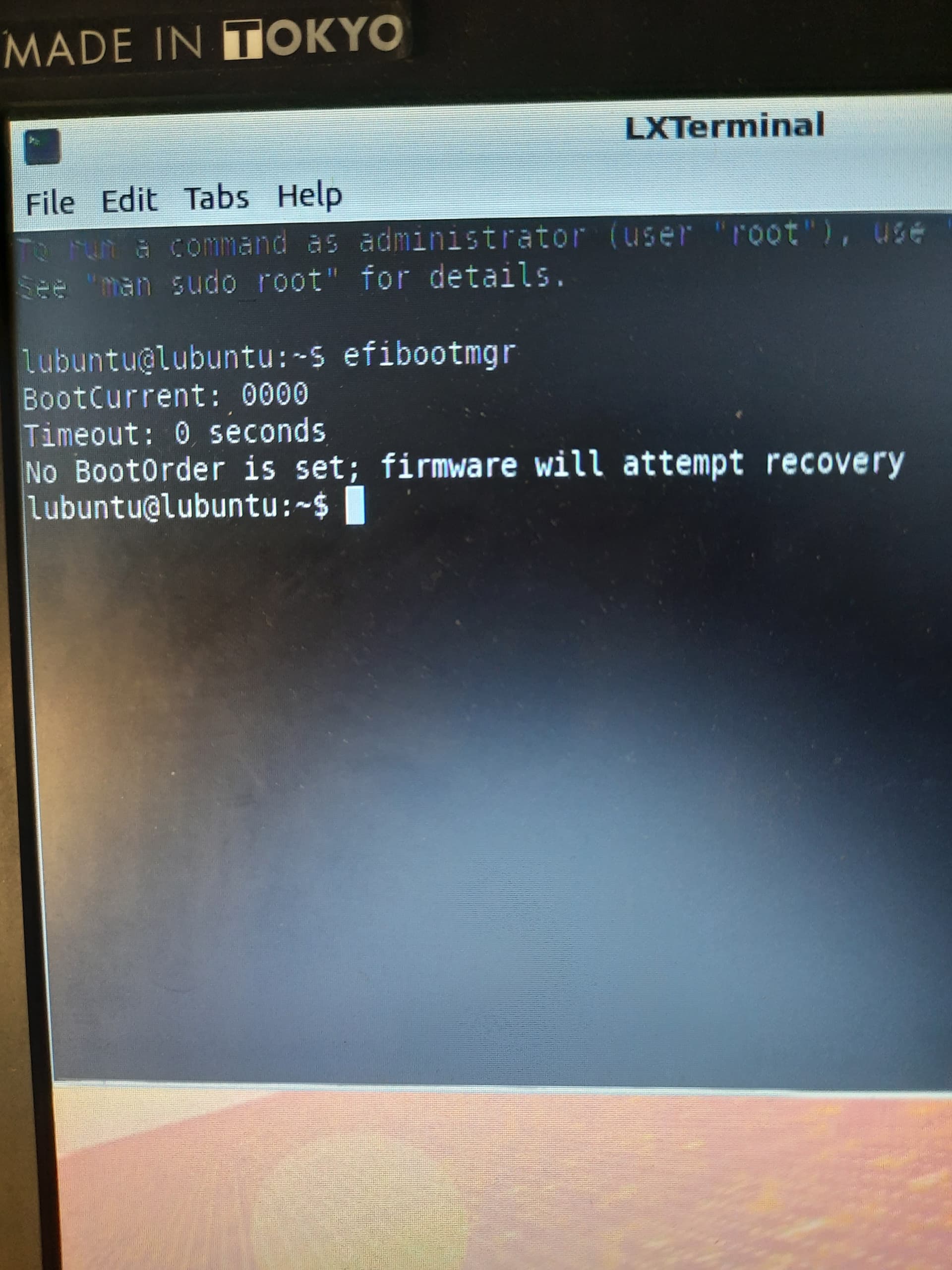

In addition to that, you could use efibootmgr from the live USB to check boot order and change it.
