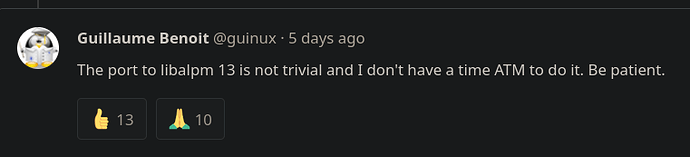

All you have to do is wait, till pamac devs fix the issue.
And welcome to the community.
Thanks. That was a lot quicker response that I expected.
Also, you should see this thread for the latest updates.

When will the Add/Remove Applications start to work? I am updating OS everyday but still the software installation program failed to start...
Start reading the posts.
So we need to wait till Arch Linux fixes the Pacman issue. :frowning_face:
No. No. No. Read.
Well if you’re in that much of a rush perhaps you should put your money where your mouth is and offer @guinix a bounty to fix pamac personally for you ASAP.
Otherwise just relax, and when it’s ready it’s ready.
Pay up, or pipe down, it’s free open source software and if the timetable isn’t fast enough for you then you can always go back to Windows or get used to using the terminal.
So its not only for me, but for all other users, the software program fails to show up. In that case, i will just wait till it get fixed. i dont want to break my system (Pacman 6 - manual intervention). Hope this issue will be solved automatically through regular updates.
