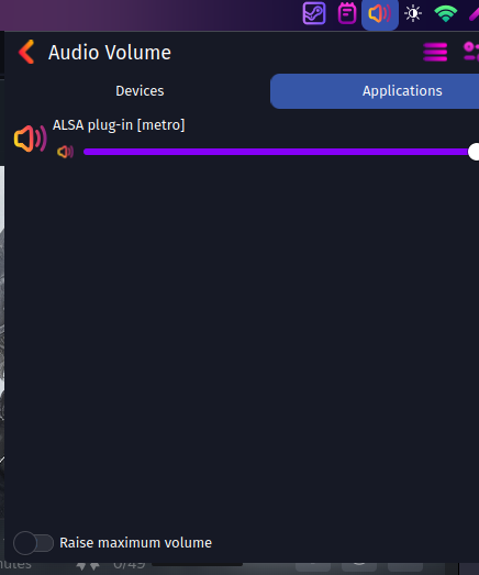

Actually i tested Lutris and Heroic Games and they are working with Sound no issues at all. Steam need to update Game so cant test with Steam now.
I can test it when update ready but so far i have no issues .
Try to restore the last snapshot before Pipewire update. Ive seen on my update it was more packages updated not only pipewire. After restoring try update again.
After reading your comment, I reinstalled the PipeWire update to test it again — and unfortunately, the issue returned: no audio in video games.
If you have time, please also check whether your Steam games work when using the Steam compatibility layer (Proton). That would help confirm if this issue is more widespread.
I was able to get audio working in Lutris by setting the Audio Driver to ALSA instead of Auto, which makes me suspect the problem lies with the recent update to PipeWire-Pulse. However, I’m not entirely sure, because I also tried launching a Steam game with this launch option: SDL_AUDIODRIVER=alsa %command% but it did not work.
Hi ,
so i tested now Metro with Steam and no sound issues here too. I didnt changed any settings somewhere. I used Lutris with Proton too. On Heroic Launcher i have a game running with Proton 9.4 also working.
