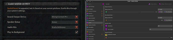

Problem
No audio in games launched from steam, audio works in all other applications

attempted troubleshooting
- Tried using
sudo downgrade libpipewire pipewire pipewire-audio gst-plugin-pipewire pipewire-zeroconf pipewire-x11-bell pipewire-pulse pipewire-jack pipewire-alsa pipewire-v4l2as suggested in this post reporting the same issue. - Found something about audio issues on ProtonDB but not 100% how to move forward with this.
- Attempted to rollback to a previous snapshot but ended up with a black screen and had to restore using
btrfs-assistant-binin recovery terminal to get to a working snapshot.
