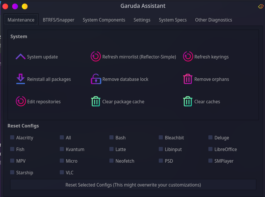

You can open a new thread on this for help, but I can tell you 2 things : First. there are already a few threads on the forums talking about resetting config files, with proper and clean solutions. Second, to make this quick in case it will help you right off the bat, you go in Garuda Assistant and you can reset some configs.
If that does not help or if you have more questions/concerns, plz open a new thread independent from this one. :slight_smile:

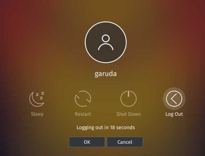

When installing package garuda-dr460nized-next and then applying Dr460nized Global Theme (with Desktop and Window settings checked on in the little prompt before applying), the Plasma Desktop icons stick with Breeze and persist after reboots.
I applied another Global Theme, the Plasma Desktop icons changed to whatever the choice of that global theme, then re-applying Dr460nized and again icons are Breeze.
ONLY the Plasma Desktop icons (top bar, User Switcher to log off, log off screen....).
I checked the config of the Global Theme and it says the icon theme is BeautyLine, which should work, but it does not for the Plasma Desktop icons. They are supposed to be BeautyLine, not Breeze.

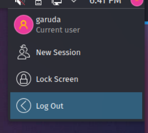

I was pretty sure my explanation wasn’t clear cuz I couldn’t remember the exact definition and you just confirmed. loll I meant the icons used like in User Switcher and Log Out screen. I think they are better called Plasma Style icons.
On just ONE of my machines they were flipping to Breeze Dark:
But I believe there is a left over config someone on that one machine cuz I could not reproduce this anywhere else.
