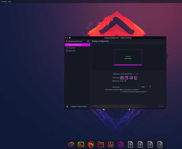

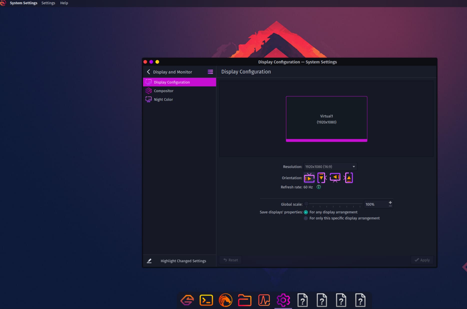

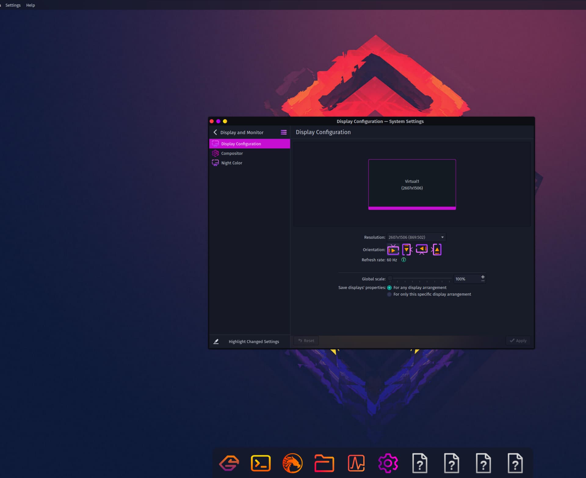

This is 2607 horizontal with above 100 thickness set:
This is 1920 horizontal with above 60 set:
It works, roughly the same eye size a bit bigger on 2607 rez, maybe 85 would be best but this is just an example to show how to use the plasmashellrc.

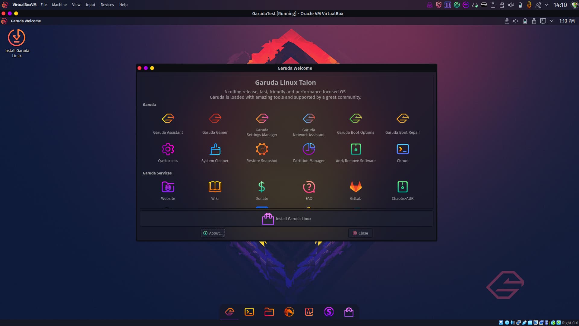

Couldn’t wait and tested it on my father’s machine, where I am for the day. Thanks to my @ and @home linked snapshots, perfect for testing.
The portability is now a LOT better. In fact, my father’s machine uses 4K rez but downsized to 85% (his eyes are getting older, he’s a great candidate to test your JS loll), an odd final rez (3264x1836).
And the result was quite good for me. I prefer the top bar a little thicker but I’m sure it is the thickness you want it to me. The bottom dock has ported properly too, nice size for the eye.
Good job! :smiley:
But there’s still something wrong with the paper yet again, man. loll It just doesn’t pick-up Ghost, Plasma is stubborn. :smiley:

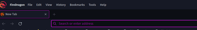

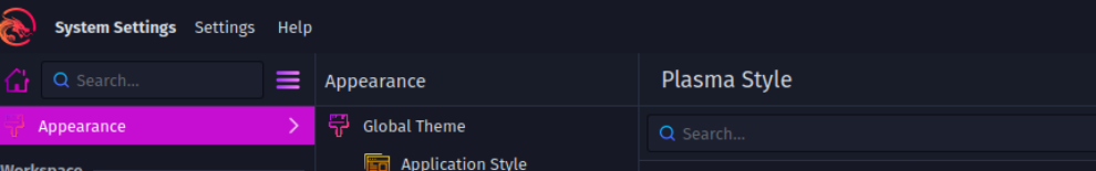

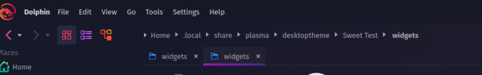

Sounds like it varies from app to app, see the different here using the same theme all 3 times.
System Settings work very well without changing anything:
Dolphin has more translucency so it’s lighter and will depend on what’s in the background:

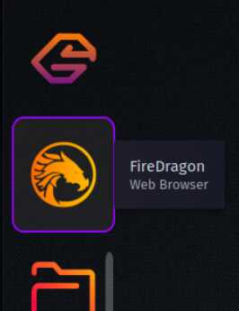

Firedragon is the worst as the tabbar is black and since it’s not part of the titlebar, it remains when maximized:

Edit: aaaaand here we go, an iso ready for testing :stuck_out_tongue: Glad it finally worked. Lemme know what needs tweaking! :slight_smile:
