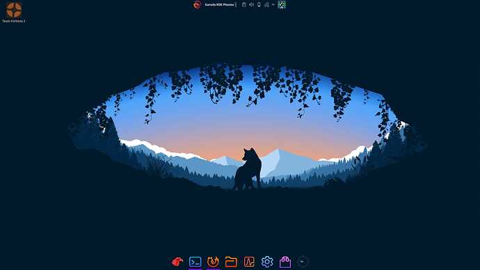

Yes, install latte-dock instead of latte-dock-git.
it looks like that now
