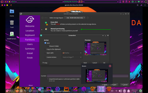

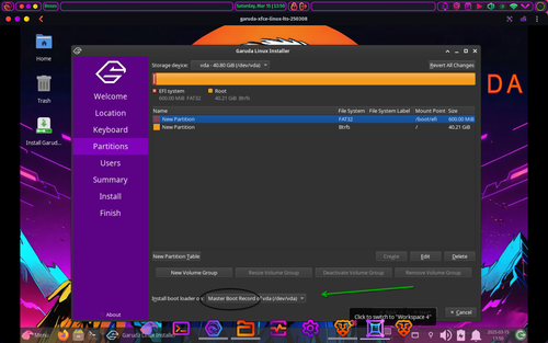

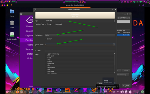

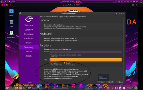

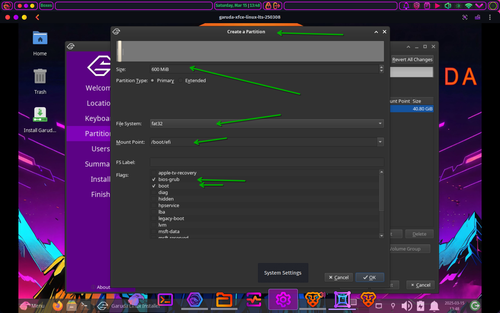

For no Problems with the bootloader even after a update from win10 i suggest create another small partiton with 600mb in fat too.May the bios entries is their after install again.
like here seen:Update issue writing to EFI - #2 by Duke187
i dont have the xfce installed yet but i download it and do the right steps then in the vm and send pictures if you want for better understanding ![]()
