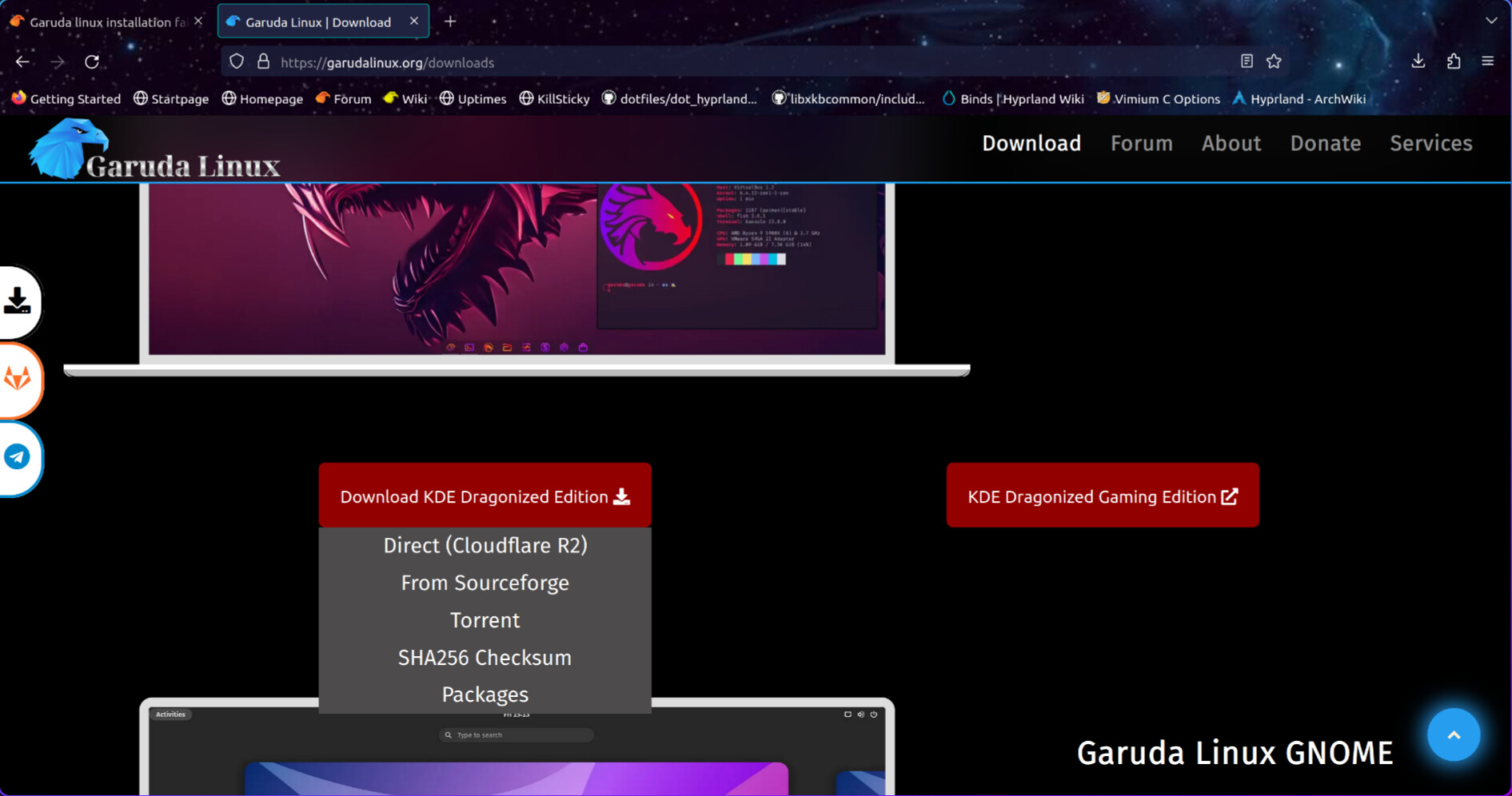

wait sha256sum? i downloaded it but it shows how to open it? idk how to.
Please use the internet to see how to match sha256sum in windows. From the website you downloaded the ISO as can be seen in the pic below there is a SHA256 checksum. Download it and match the sha256 there with your ISO. If the two match there is no corruption in the download of ISO.
PS C:\WINDOWS\system32> "C:\Users\Tegveer Singh\Downloads\garuda-dr460nized-linux-zen-231029.iso.sha256""C:\Users\Tegveer Singh\Downloads\garuda-dr460nized-linux-zen-231029.iso.sha256"
C:\Users\Tegveer Singh\Downloads\garuda-dr460nized-linux-zen-231029.iso.sha256"C:\Users\Tegveer Singh\Downloads\garuda-dr460nized-linux-zen-231029.iso.sha256
PS C:\WINDOWS\system32>  Get-FileHash "C:\Users\Tegveer Singh\Downloads\garuda-dr460nized-linux-zen-231029.iso.sha256"
Algorithm       Hash                                                                   Path
SHA256          194B5FAFFC6B04B44A98AA08D882554F4EB39ACA80D703512070D49EE5D383A5       C:\Users\Tegveer Singh\Downlo...
PS C:\WINDOWS\system32> Get-FileHash "C:\Users\Tegveer Singh\Downloads\garuda-dr460nized-linux-zen-231029.iso"
Algorithm       Hash                                                                   Path
SHA256          B3400172F03A9EC18B6F86FB8BB6DB9C2EC7BD407C35670F873A59A5CA0EEE98       C:\Users\Tegveer Singh\Downlo...
they are pretty different
You don’t calculate the hash of the file containing the correct checksum value… This file contains the hash as ascii text that you can open normally and check if it matches this,
Do the contents of .sha256 file match this string? You can use an online string comparison checker to verify this.
