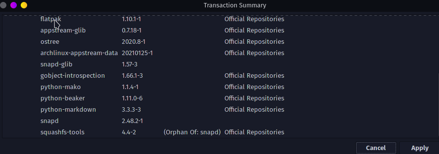

Quick question (sorry for being off-topic again), but why does garuda require snapd.
The real Depends of assistant is
depends=('qt5-base' 'xdg-utils' 'polkit' 'alacritty' 'micro' 'reflector-simple' 'hblock' 'xorg-xdpyinfo' 'pace' 'pamac')
Maybe your pamac version draws in those. There are other versions, though IDK if they are different.
Check AUR relevant packages PKGBUILDs to see.
Perhaps it’s a dependency of pamac-all ?
Hmm pamac-all says
if [ "${ENABLE_SNAPD}" = 1 ]; then
  depends+=('snapd' 'snapd-glib')
  define_meson+=' -Denable-snap=true'
  provides+=('pamac-snap-plugin')
  conflicts+=('pamac-snap-plugin')
But I have snap disabled in the settings…

Pamac’s GUI settings aren’t related to the pamac-all package dependencies.
Doesn't it say
if enable snapd = 1
add: depends on snap d
In the packaging source file, yes. That determines the package options. You can check the end result with e.g.
pacman -Si pamac-all
This will help find the solution.
