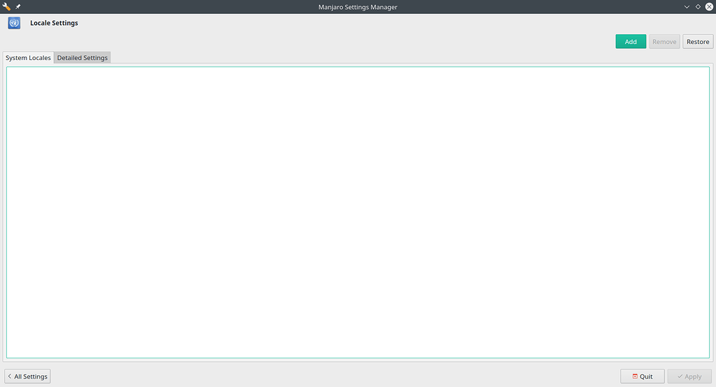

I remember changing locale from en us to en india via Garuda system settings because I was familiar to it since I had used Manjaro xfce before. Now I am not able to change it back to en us. I recognise the issue now. The auto-completion works well with en us. Also live boots have no issue.
When I click the restore button, I am back to en india locale. When I right click on en us and click on option to set it as default it changed. But when I hit apply settings it's lost and I am back on en india locale
I think creating a new user might not work as locale is not different for each user.
Also reinstalling Garuda settings manager might be an option. Not sure.
Might change locale to something familiar like en uk?
I think it's not about Garuda configs or fish. Its about the garuda-settings-manager. This thread might be common for Garuda as well as Manjaro as both use the same app. I could head over there as well for help if you guys don't mind. I am not sure about relations of Garuda with other distros, all I know is endeavour os guys are not comfortable with us.Reinstalling will be my last resort. Till then I want to make all attempts to change my locale to enUS. Can I post the same issue on Manjaro forum after all the helpers over here have done trying out? They also can help with locale as Garuda and Manjaro's system settings manager are very similar. I wait for a Garuda team member for answer over this.
I understand. But I desperately need help. I have done everything I can. even sudo locale-gen is giving me an error. Can anyone help me? Where do I go? Am I abandoned? Any place where I could get help?
Does that mean there is no hope of getting help here? I am ready to fully co-operate with anyone, in case you have free time. Please help me if you can, would be great.
