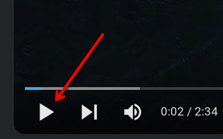

Sadly I have the same issue. Youtube videos simply don’t load.
When I click the play button, the video just keep trying to load. The ads play fine though. I disabled uBlock Origin and Privacy Badger of course.

For 11.17
Videos start playing but shortly after it stalls, only showing that it tries to load.
Pressing play-button or a reload of the page have no effect. This affects youtube content, and I checked Vimeo to see if other video-content had problem. Also videos embedded on other sites works. Even those from youtube.
In 11.16 everything works.

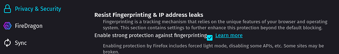

For those where YouTube videos just stop indefinitely trying to load, could you please try playing the video in a private window or activating “Strong Fingerprinting protection” in the “Privacy & Security” settings?
Simply playing in a Private Window works for me.

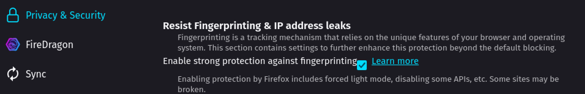

This way it works. Fingerprint solve the problem for NORMAL Mode too. Ty and great Garuda Project!
Both private window and the fingerprinting in normal window makes it work
So, what about the strong fingerprinting makes it work?
Yep same thing for me. Both private mode or enabling strong protection against fingerprinting solves the issue.
I’m wondering the same here. Just enabling that option on version 11.17.4-2.1 with the default profile that was previously experiencing the audio issue, now clears it up after restarting the browser.
Just be aware that Fingerprinting will cause some other issues in other types of use cases, so it’s a double-edged sword. Once you are aware that FP can cause issues elsewhere, whenever you have an issue the first test would be to disable FP and if it works you can temporarily disable it for that specific use case and re-enable when you go back on Youtube.
