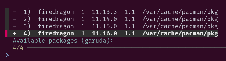

You may not like this but my next try would be to downgrade your FD back to 11.16 and see if you don’t get the issue.
sudo downgrade firedragon
If you do still get the annoying half-speed, then we can be quite sure it is not related to 11.17 upgrade.
Whats the version before 11.17? I cleared pacman cache to see if reinstalling it very fresh would fix it before opening a bug report and it’s just trying to install the currently installed version

I am still unable to downgrade, I’m going to wait to ask my partner who also runs garuda if they have an older version of firedragon in pacman cache as soon as they wake up, I only cleared cache originally so it would redownload fresh to see if the download got corrupted.

You should at least be able to get 11.16.
I downgraded to 11.16 and it’s working again.
