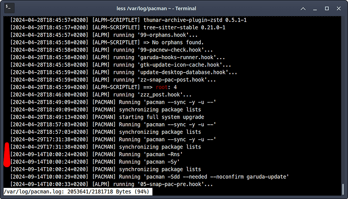

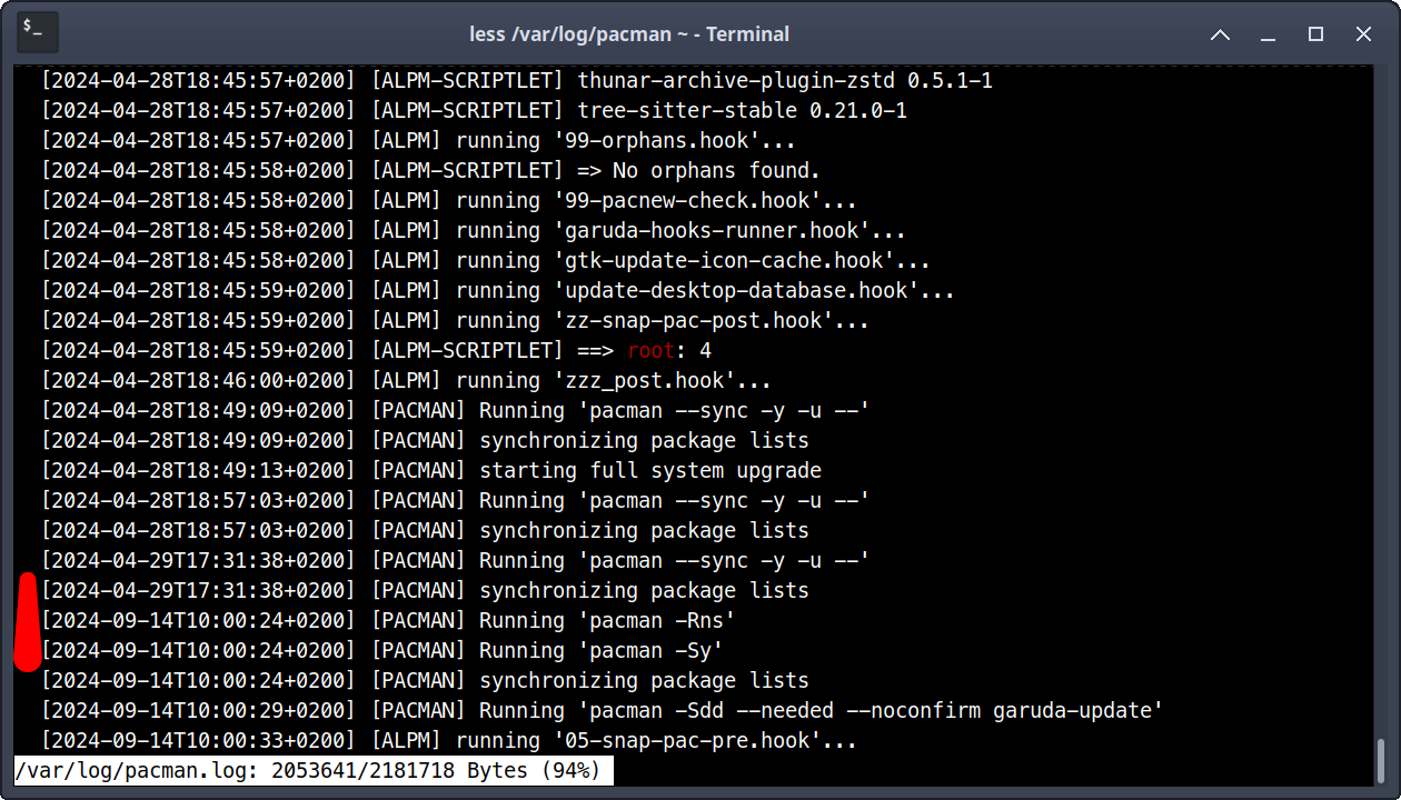

Off topic: we know that rolling release distributions are best updated often. I could not do the system update because I was abroad and forgot my laptop at home. I came back after five months, updated the mirrors and the system and everything worked fine! Look at the picture.
