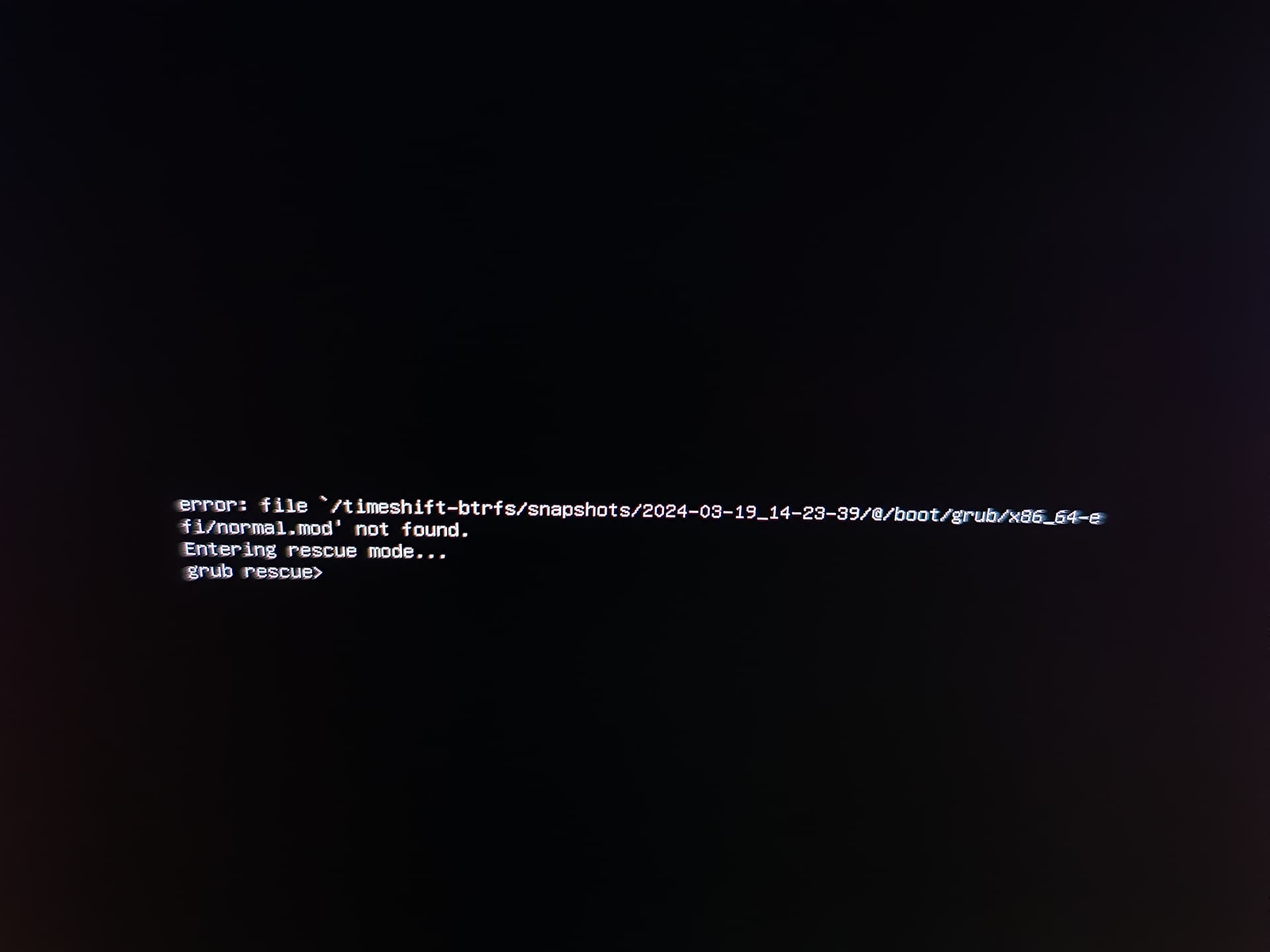

I was waiting garuda-update to finish as usual. Suddenly a lot of errors appeared on the terminal and my laptop became unresponsive. I tried everything but no window was opening anymore and I couldn’t open the terminal or any application anymore.
I waited a few minutes and gave up. After rebooting, this is what appears now:
error: file ` /timeshift-btrfs/snapshots/2024-03-19_14-23-39/@/boot/grub/x86_64-efi/normal.mod' not found.
Entering rescue mode...
grub rescue

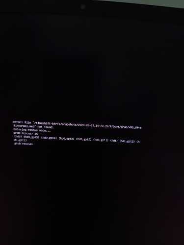

I have two SSDs: one contains Windows, the other contains Garuda Linux
This is what I see when typing ls
I would really like to try something so that I can at least push the code I worked all these days… I would appreciate any help or guidance because I’ve never seen this grub rescue screen before.
You could try restoring the latest working snapshot, although I see the error is about a missing snapshot, so it could be that you have been working on a snapshot for a while and something went wrong. Just try.
I don’t remember much about timeshift, since we moved to snapper since quite some time now.
If that doesn’t work, you could try booting with a live USB, chroot and see if you can update from there. And maybe reinstall the GRUB as well.

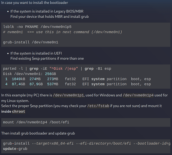

I have a doubt here about the instructions that @BluishHumility has given
I followed these instructions
I don’t know if my system is installed in in Legacy BIOS/MBR or UEFI. Not sure how to obtain this information. Not sure which instruction to follow.
I have two SSDs, one with Windows, another one with Garuda.
I appreciate any guidance at this step!

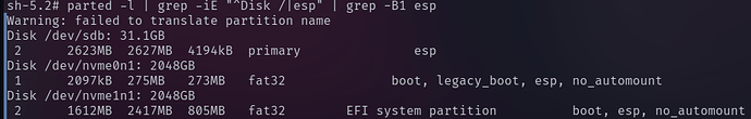

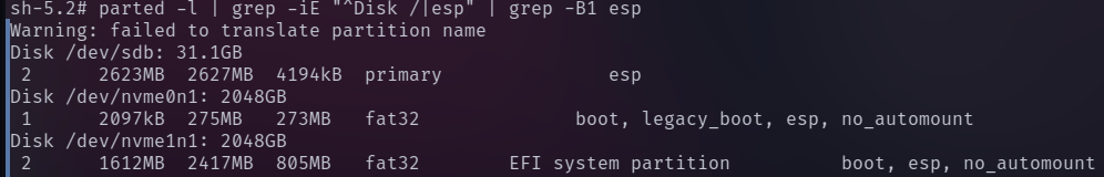

sh-5.2# parted -l | grep -iE "^Disk /|esp" | grep -B1 esp
Warning: failed to translate partition name
Disk /dev/sdb: 31.1GB
2      2623MB  2627MB  4194kB  primary               esp
Disk /dev/nvme0n1: 2048GB
1      2097kB  275MB   273MB   fat32              boot, legacy_boot, esp, no_automount
Disk /dev/nvme1n1: 2048GB
2      1612MB  2417MB  805MB   fat32        EFI system partition          boot, esp, no_automount
it means in my case I need to do this?
mount /dev/nvme0n1p2 /boot/efi

So you can proceed with the UEFI command.
Consider also the tip in the tutorial.
Select the proper $esp partition (you may check your /etc/fstab if you are not sure) and mount it inside chroot
Please do not use pictures for terminal text in the posts.
This is your esp, not
