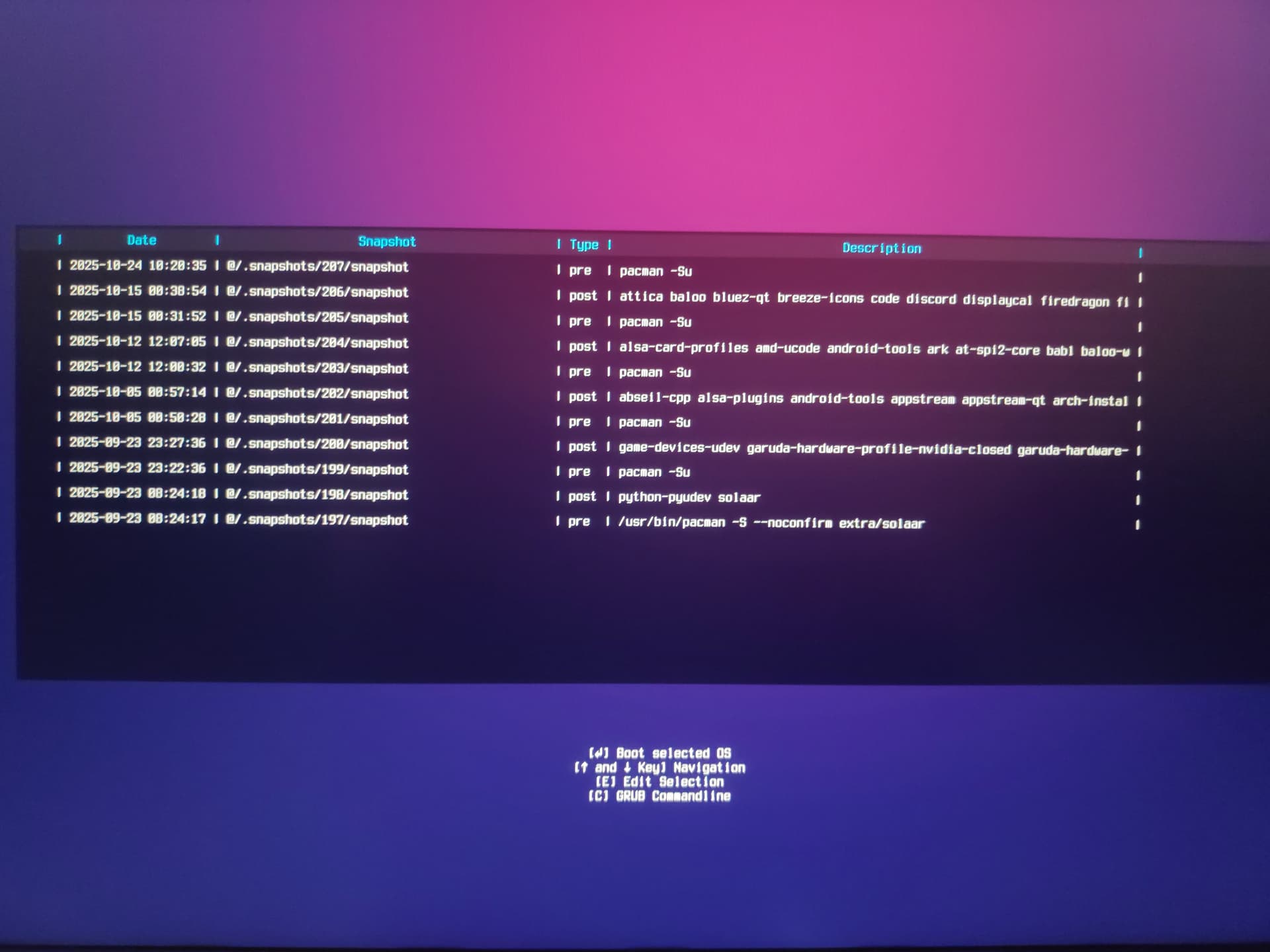

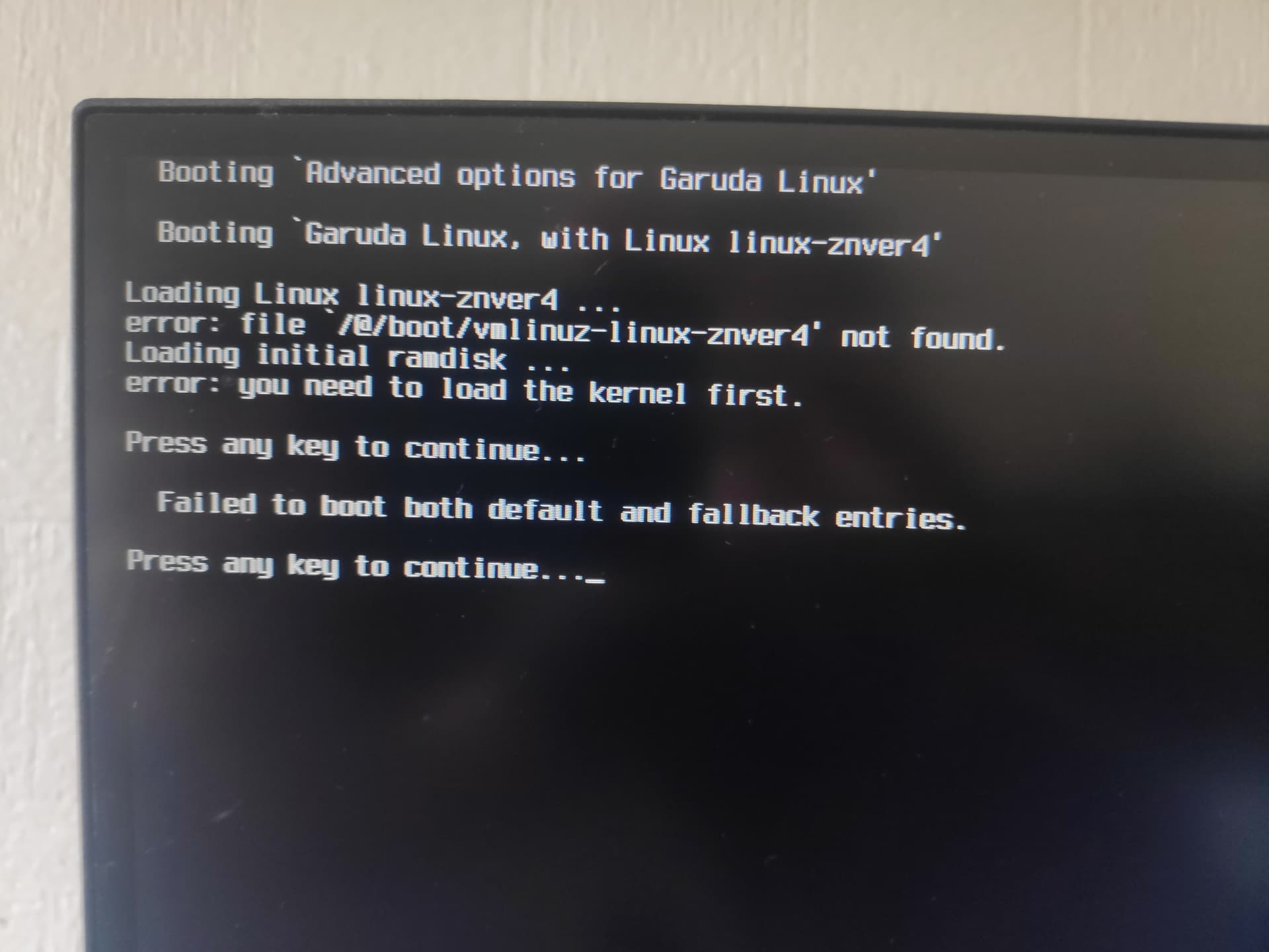

While booting today, I get the message joined (sorry for the picture). After the last part, the system goes back to grub and I can do nothing because my keyboard is not working. I tried 2 different keyboards, no movement possible. Both keyboards works in the bios.

Is the keyboard working on a cold boot before the error comes and you can chose a snapshot ? ( or other kernel if its installed)

The keyboards are not working in grub, be it before or after the error.

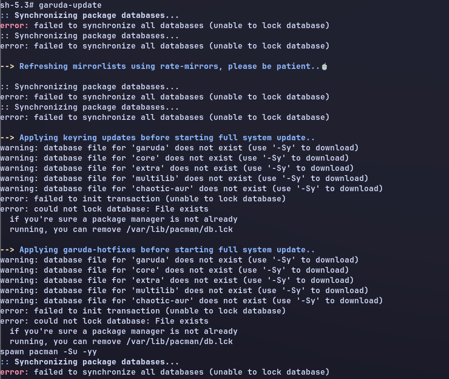

I am apparently in chroot of my system, but fail to update:

This is an extremely bad omen. You have a corrupt grub (theme and modules aren’t loading) as well as a missing kernel.
This screams that something went horribly wrong. It seems like you might have deleted the /boot folder somehow.
At this point, I advise that you start “Garuda Boot Repair” on the live ISO. You’ll want to select the reinstall Grub option, then select “ESP”, select the correct partitions, and you should be good to go.
Afterwards, reboot and the keyboard should respond in grub again. Do NOT attempt to boot the system normally. Instead, boot the last working snapshot and restore it permanently immediately after logging back in. There is usually a pop-up that will ask you to do so.

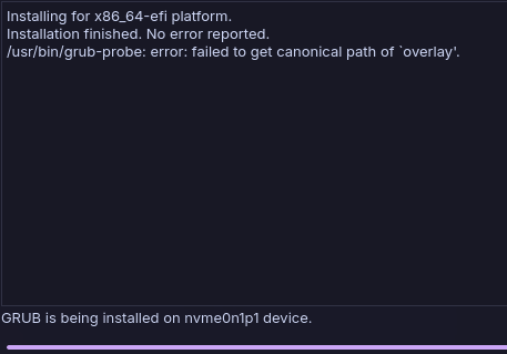

I did that, got this message.
something went wrong? or is it good?
I rebooted, nothing has changed. No kernel, grub not responding.

Gotcha. In the chroot from earlier:
Run update-grub as well as dracut-rebuild.
And try again.
Now, the grub goes to this page, but I can still do nothing. No input from any keyboard works.

According to this, it seems you started an update, but you never finished the update, as in you closed the terminal or force shutdown the PC while the update was running. This is why you are experiencing this trouble.
Since I couldn’t correct or repair my mistakes, I went with a clean install of Mokka (I wanted to try that version of Garuda), everything seems fine now, I also updated my BIOS (Damn MSI who automatically put SafeBios and TPM on by default). Thank you all for your quick support.
