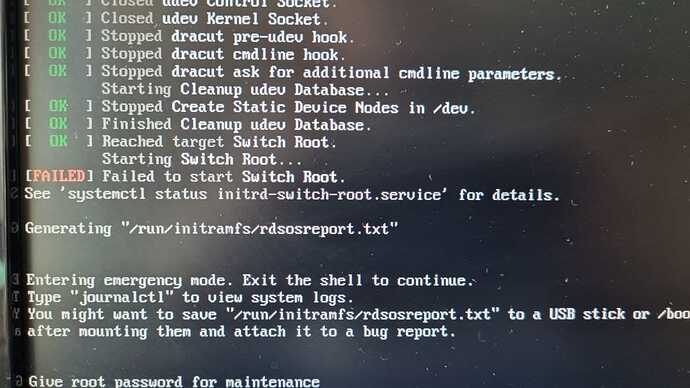

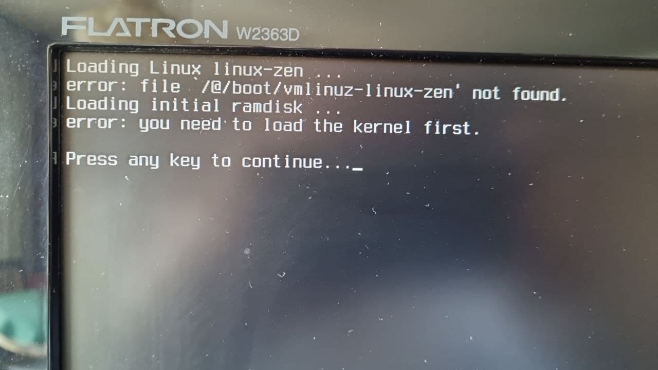

Hi there,
excuse me if I cannot post my garuda-inxi and have to resort to screenshots, but since I cannot boot I’m afraid this is the best I can do. :cry:
I couldn’t update since my root partition (50gb) was apparently full.
So I deleted some snapshots, cleared cache and orphans via the Garuda tools, then tried rebooting and… I cannot boot anymore, and the five snapshot I have do not work as well!
This is what I see if I try to boot linux-zen or linux-lts (I have both installed, keeping LTS as a fallback):
And this if I try to boot any snapshot:
Can I do something or am I simply done? :frowning:

Boot from a live USB, muont your system partition and free-up/move as much space as possible, if this is really the problem.
From the live USB, once the system is mounted, you should also be able to access your snapshots in the Btrfs Assistant and delete some old snapshots.
If that’s not enough, you should consider chrooting from the live USB into your system and, having made some space, you should be able to update or just reinstall the kernel, if that’s the problem.
Before updating, you could free up a lot of space with:
sudo pacman -Scc
(well sudo is not needed when inside a chroot)
Ops, I just noticed:
You could try chrooting anyway and updating, now that the disk space should be available.
