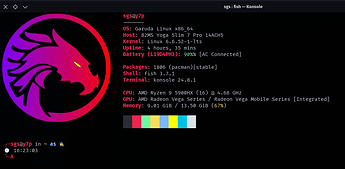

I test on KDE, no missing symbol on konsole or yakuake.
In the end, yakuake and konsole works for you? Or did you use another terminal :slight_smile: ?
