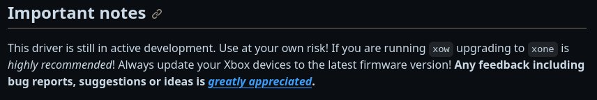

Thank you dear for your kind reply, but I have already installed the driver in question:
╭─sermor@sermor in ~
╰─λ cd xone
sudo ./install.sh --release
[sudo] password di sermor:
Driver is already installed!
As well as the other drivers: xboxdrv, xpadneo, and xbox generic controller.
I installed these drivers via garuda gamer at startup after installation. You could say it’s among the first things I did. The drivers are installed, but the xbox pad is still not recognized. Thank you for the time you dedicated to me.
