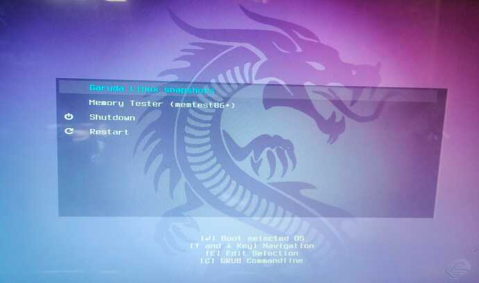

Now the problem got much more it doesn't show the garuda linux and windows 10 also

No this after installing garuda again
And have snap shots now but i wanna boot in to the system not in the snapshot and i have windows 10 installed but it doesn't appear here
