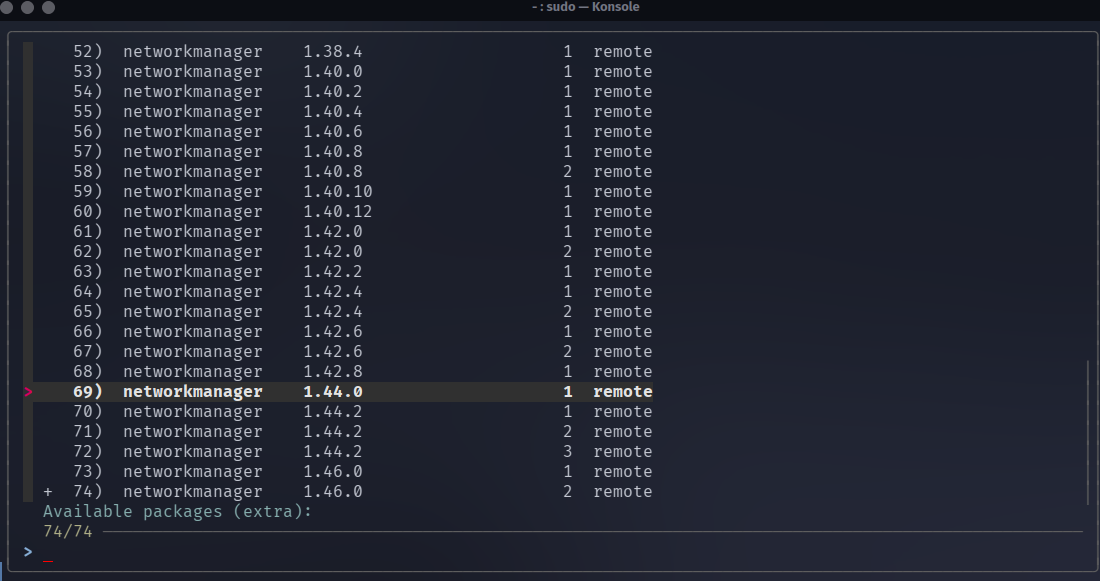

maybe try to downgrade the networkmanager with "sudo downgrade networkmanager " and chose a numbered before not same who is installed.

networkmanager 1.46.0-2
wpa-supplicant 2:2.10-8
dhcpcd 10.0.8-1 not installed both sides.
