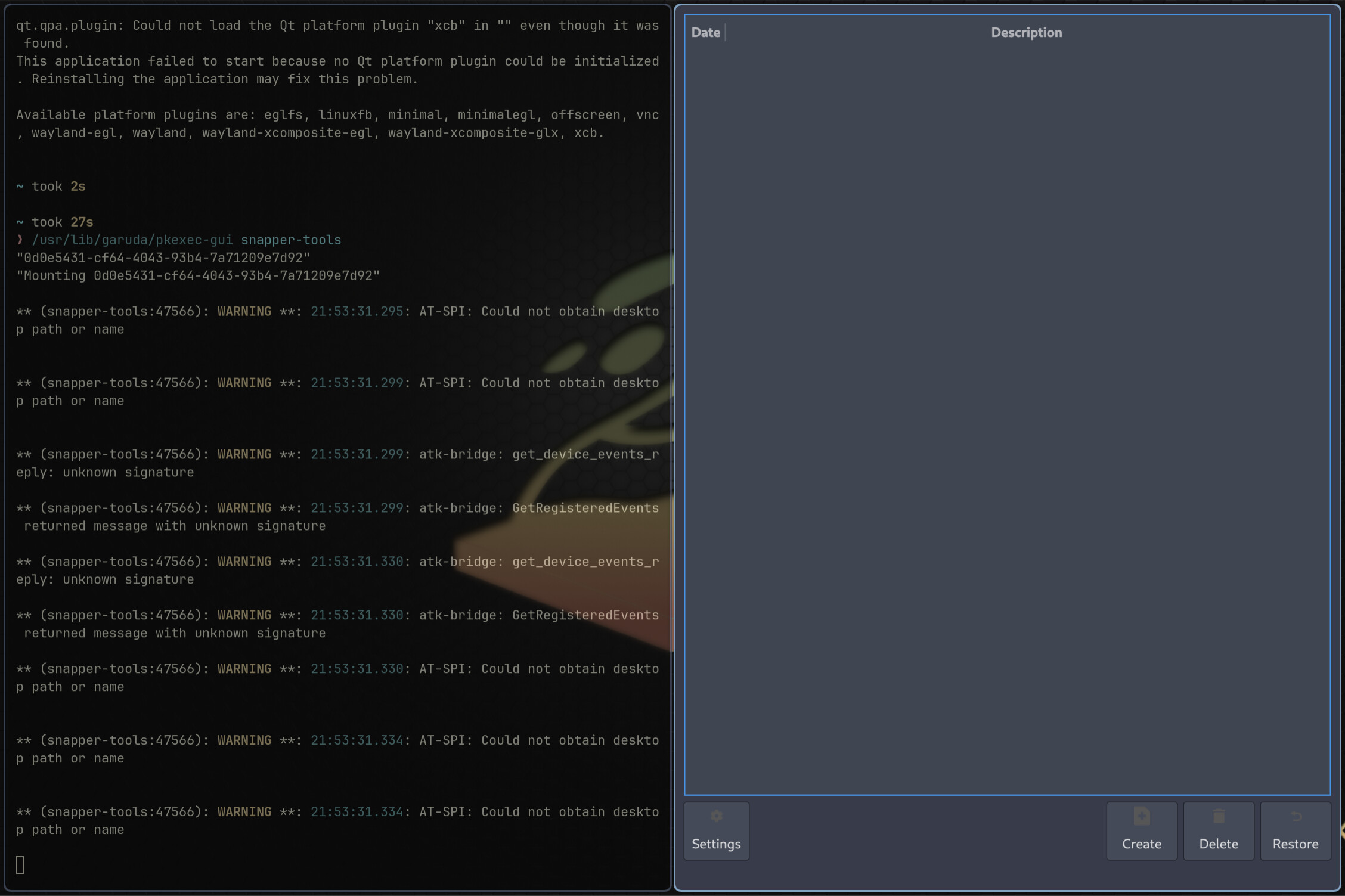

I figured out why Snapper Tools is empty on the machine I tested on: backend.cpp · main · Garuda Linux 🦅 / Applications / Snapper Tools · GitLab
for (const auto& volume : qAsConst(volumes)) {
static QRegularExpression re("@\\/.snapshots\\/(\\d+)\\/snapshot");
QRegularExpressionMatch match = re.match(volume.path);
if (!match.hasMatch())
continue;
Only subvolumes whose paths conform to this specific format (i.e., starting with @) will be processed to extract snapshot information. I was testing on a system where the subvolumes have been renamed to something else, so they do not match the regular expression and are skipped in the loop.
Can someone on KDE Dr460nized or Mokka test if launching Snapper Tools from the terminal with the pkexec-gui tool preserves the theme?
/usr/lib/garuda/pkexec-gui snapper-tools
If so, maybe we can just change the desktop file to use that for launching it.
