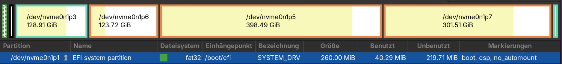

I use 4 OS on this notebook, my efi use 260 MB
the OS’s need just 40.29 MB, so for two OS 100 MB are enough I think, but I can fail :slight_smile:
