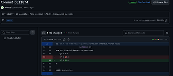

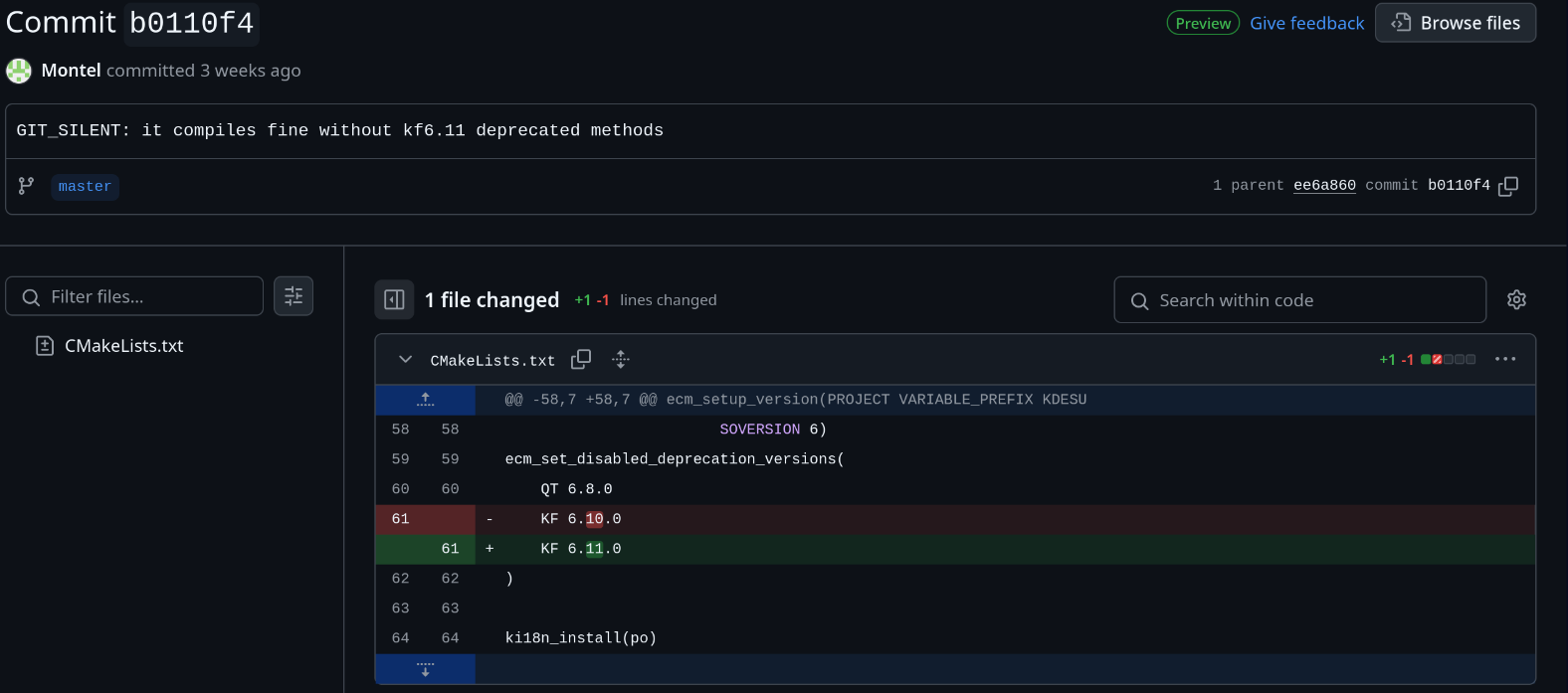

kdesu is also deprecated now as well on the kde side.
As, @elite has pointed out, kdesu command, which is a part of the kde-cli-tools package,
$ pkgfile kdesu
extra/kde-cli-tools
doesn’t compile with it any more.
So maybe I will remove it from the guide.
I think the kde usecase now is dbus? But I could be wrong on that.
