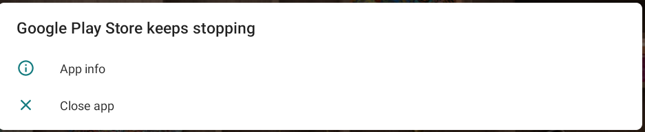

Hello, thank You for that giude. I install everything like in Your tutorial and everything works great. But next day when I launch laptop and start waydroid I get error that Play Store crash again and again. I uninstall it with waydroid-extras but notting happen. Still shows me that crash info. How to fix that?
Regards.
There are other ways to install the play store, you can try those and let me know if it solves the issues…

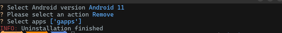

But how to completly remove it?

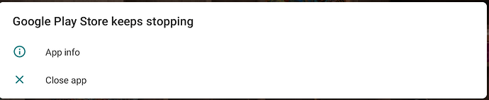

Look I uninstall with waydroid-extras and still have that crash:
Regards
Now, did you install the waydroid image using any of the above ‘other methods’?
You must have then again installed GApps using the waydroid-extras command.
That would be the reason you still have the Play Store app.
Secondly, did you register your waydroid device with Google after you had installed GApps?
Google Play Store still works fine at my end…
