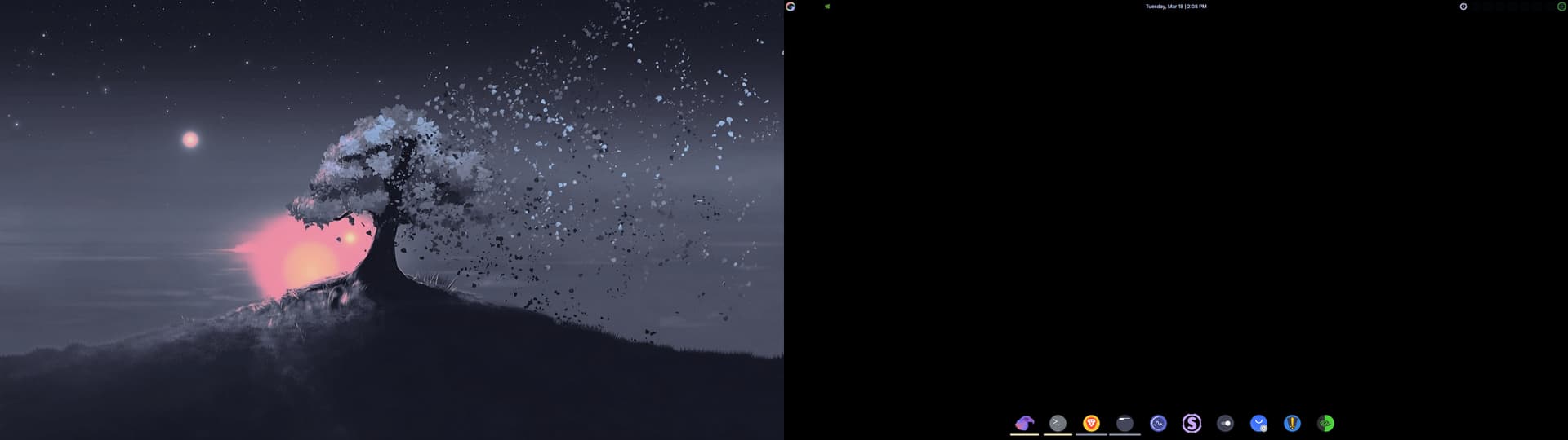

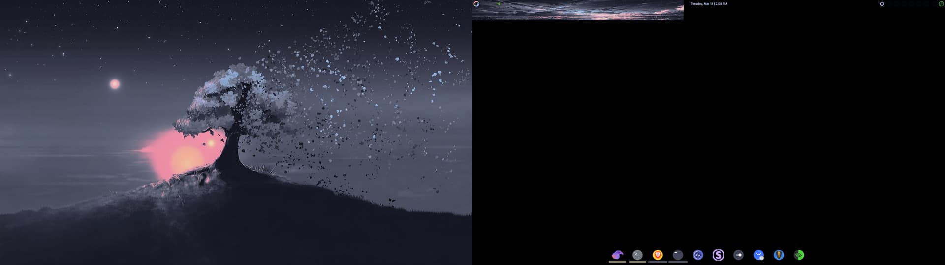

Yeah, everything works fine on X11 but this is actually the first time ive had an issue on Wayland and I can still play games. I played The Ascent for hours last night on wayland no problem but as soon as I quit and switch to another game the issue comes.
I was able to kill steam and regain control and this is the result.
then If i reboot it will clear up.

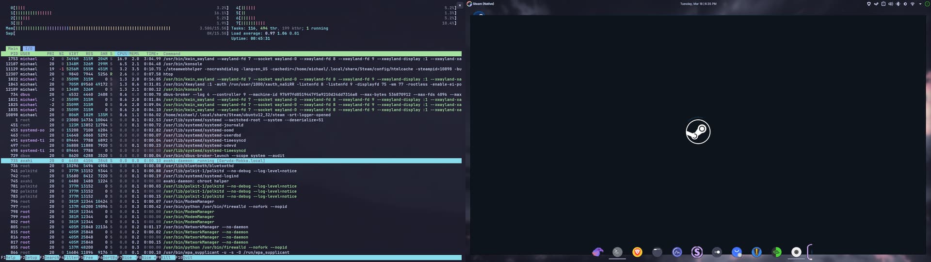

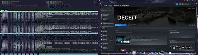

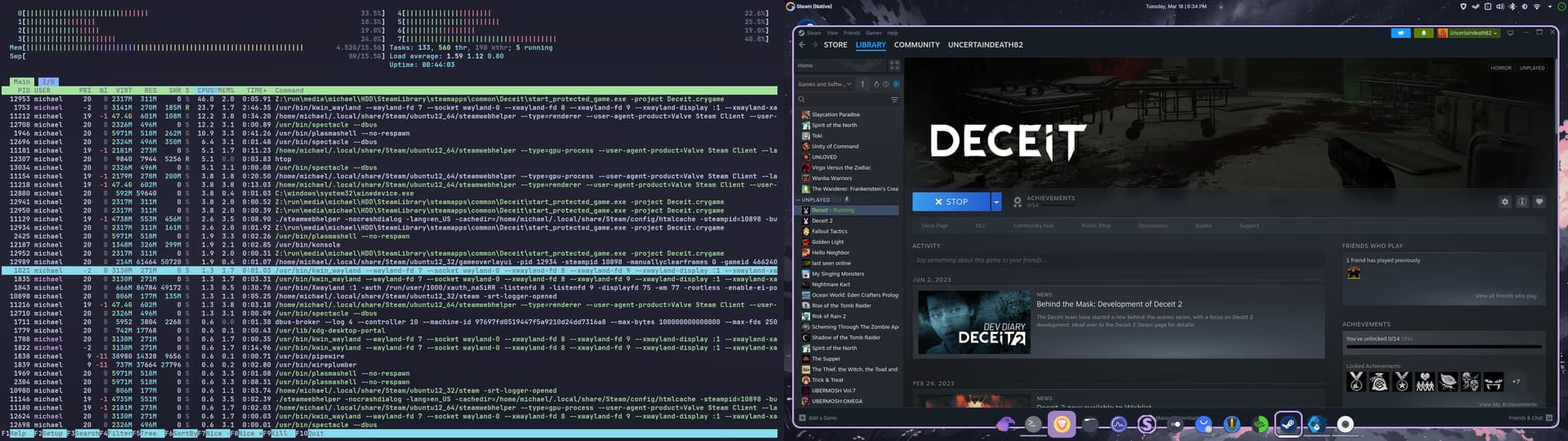

What bothers me is that this only occurs on wayland:
Open htop in the terminal and watch the CPU/MEM utilization as soon as the issue occurs.

@uncertain122 htop looks good, no indication that wayland or anything else is the cause of the freezing/hanging and Xorg.0.log is clean.
What bothers me is this:
I noticed kwin-OpenGL errors in the logs and your nvidia GPU is not recognized as OpenGL renderer. This is what it should normally look like:
