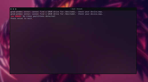

Btw. there is no need to post Screenshots from terminal text.
Images can be read worse, are not searchable and copyable for further search.
yes you’re right, I apologize
Anyway garuda-chroot -a answers me with:
grub-probe: error: cannot find a GRUB drive for /dev/sdd2.  Check your device.map.
==> ERROR: No Linux partitions detected!

Manual intervention is required!
Error! vboxhost/7.0.18_OSE: Missing the module source directory or the symbolic link pointing to it.
Error! vboxhost/7.1.0_OSE: Missing the module source directory or the symbolic link pointing to it.
Nothing new, I tried uninstalling nvidia-dkms and virtualbox-host-dkms, removing the nvidia and vboxhost /var/lib/dkms folders and reinstalling just the nvidia drivers.
“dkms status” did not return any errors. I get to the sddm boot screen and it gets stuck.

yes, I had already tried it, I tried changing drivers, kernel, updating individually after removing the dkms… nothing.
In those few times that it managed to start (with each of the various tests) the second monitor was not recognized and the first had a resolution of 1024x768 without the possibility of choosing others.

Perhaps try dracut --regenerate-all --force in the chroot ?
did you read at the beginning of the post about chroot? :cry:
Sorry but I do not see any commands with dracut, might just be me. Try a different kernel as well perhaps ?
being quite noob, I fought until I entered the chroot, ran update, but nothing solved.
I tried with vanilla kernel, zen, cachy…
