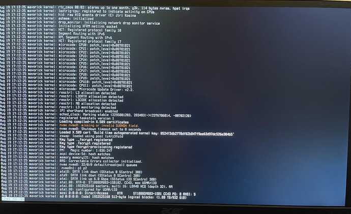

The output was over 1000 lines long, so I got some pictures of colored errors that I thought were important:
Let me know if I need to post more information
Ah, I cant find the order of the images. Go through the logs and post anything looking like errors.
