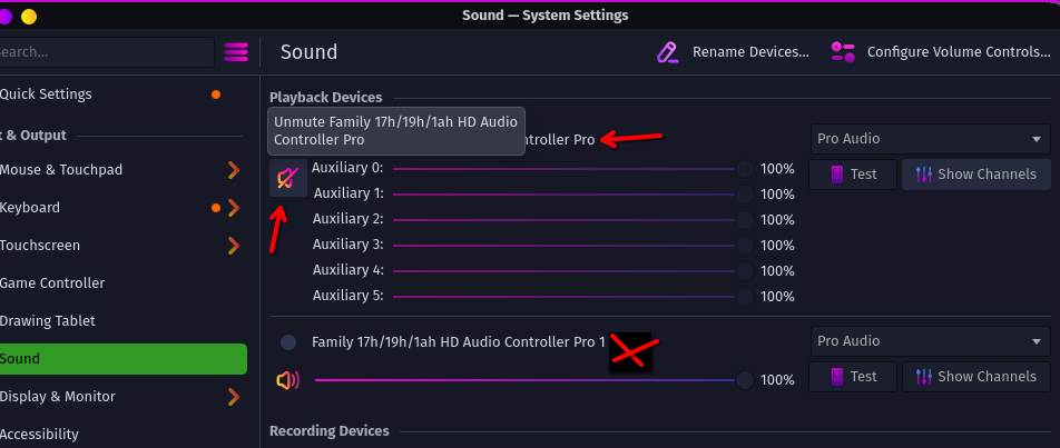

Hello ,
First at all i could think that is a bios issue. ( i had it myself too few times until i updated to newest version.
https://www.msi.com/Motherboard/B550M-PRO-VDH-WIFI/support
2 posts were split to a new topic: Step by step guide what i can do to update my BIOS
Also please check that you have the right Controller Pro not Pro1 and is not on mute state.
