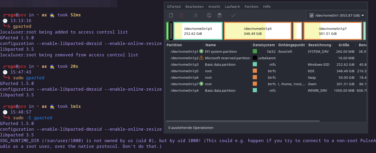

:: (V)iew, (M)erge, (S)kip, (R)emove pacnew, (O)verwrite with pacnew, (Q)uit: [v/m/s/r/o/q]
Authorization required, but no authorization protocol specified
After install "xorg-xhost" problem are solved.
gparted
localuser:root being added to access control list
GParted 1.5.0
configuration --enable-libparted-dmraid --enable-online-resize
libparted 3.5
localuser:root being removed from access control list

No idea, I started gparted in terminal for demonstration, password prompt and running.
The output shows what xorg-xhost does. IDK how access control list work :smiley:

I wonder if this is another weird environment variable thing? For me, sudo gparted fails, but sudo -E gparted runs fine.
Not more in terminal, pop up for password, gparted open/run.
Edit: i3wm With -E I got the “dark” version, the other two are “light”
