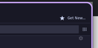

Sharp Shadow Corner When Blur Enabled (Rounded Corners)
I migrated to Garuda Mokka by following this guide: Release Notes and Migration | Garuda Linux wiki
I love the aesthetic and the rounded corners. However, I noticed that when I enable both the blur and rounded corners, there is a sharp shadow corner behind the rounded corners.
So far, I have tried:
  • Setting corner radius in Better Blur > Rounded corners
  • Switching between Blur and Better blur
I have read these posts:
I didn’t have much luck with either.

Yeah that is the famous very very old Plasma issue with the Border Shadows. The best we could find to prevent this as much as possible what using Rounded-Corners.
However it does not prevent it 100% of the time, but very close. That being said, you should not have the issue consistently.
As of now I cannot reproduce this.
Rounded-Corners is the one to play with to change this behavior, however since we are using this I have seen the issue appear maybe once or twice and that is in a year+.
Better-Blur and Blur should not have any effect on those shadows.
Make sure you are using default Rounded-Corners settings.
And make sure you are using the correct Window Decorations (Catppuccin-Mocha-Classic).
It is possible Wayland vs X11 makes a difference, but I have no proof on that.
Nvidia might come at play, but again no proof.
Thank you so much for taking the time to reply!
I think it’s possible Nvidia is the culprit here. Although Better Blur should not play a role, I notice that the sharp corners only appear for me with blur enabled. Any thoughts why it disappears when blur is disabled?
Yep! Confirmed I have that window decoration set. I used the rounded corner settings suggested by the migration guide and since then have only changed the corner radius, but the issue occurs even for a corner radius of 10.
Ok, it’s not Nvidia I don’t think. I installed on an external disk and running on the same hardware and the issue is not occuring there.
I don’t even know how I got into this state, but I needed to set my anti-aliasing parameter in Better Blur settings to 1.
Oh that’s interesting, I have to add this to the wiki!
Thanks
