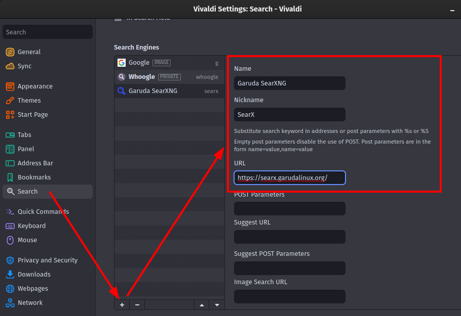

In the Vivaldi settings menu you can add search engines. Click the + button, then add the name/nickname/URL:
After you add it, scroll up a bit on that same page and you can set it to be your default if you’d like.
2023-08-10_15-28
If I simply do that, the search terms in the address bar do not get passed over. It sends it as POST by default so I don't see the right syntax either. Tried putting "%s" in the POST and that didn't work either.
Need to know the exact syntax that searX expects.

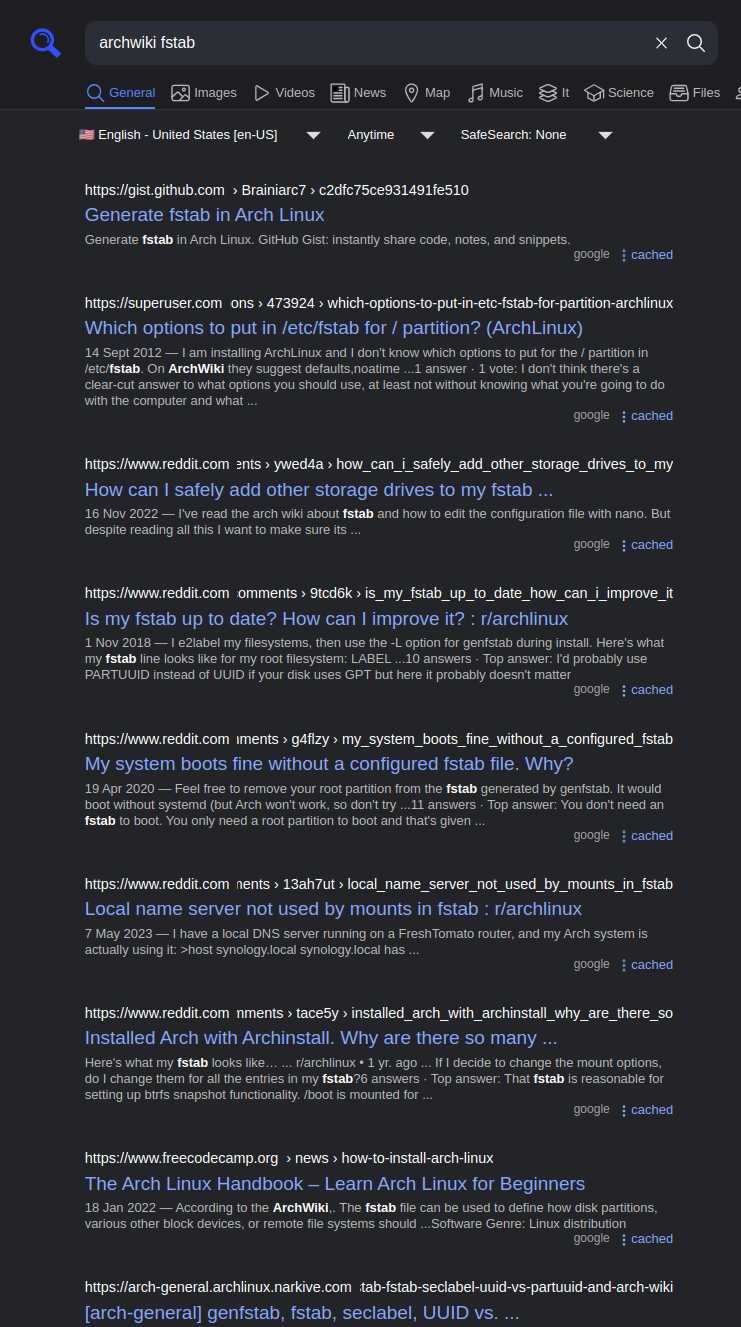

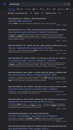

I hate to say so, but I feel like the SearX search results are not that good in a lot of cases. It never seems to pull up ArchWiki articles I am after, for example.
If I search for "archwiki fstab" I feel like this should be the first result. Instead, it doesn't seem to show up at all--I scrolled down through hundreds of results and it wasn't there.
Is there some additional configuration I am missing?
Looking at this, it seems to be better when setting language to "all" :face_with_monocle: maybe this should be our default.
Oh wow, that is a big improvement! I agree this seems like it should be the default.
The [en-US] setting seems to be 90% Reddit for some reason. :expressionless:

Try the URL as:
https://searx.garudalinux.org/search
With the POST parameters as:
q=%s
ah I was just missing “q=” from the POST parameters.
Kind of works… if I type “best games 2023”, it shows this in the search box
best%20games%20of%202023
Just a character escaping problem
Ya, I noticed that as well. At least it works and just seems like a cosmetic issue doing it that particular way :man_shrugging:
placing q=%s in the URL instead of POST works though
good catch. Doing https://searx.garudalinux.org/search?q=%s as the search URL (and not using the POST parameter field) solves that cosmetic issue.
It's probably a bug in searX engine itself that could be fixed: properly parsing POST data for display
Reported the bug here

All is now the default search language for better results.
