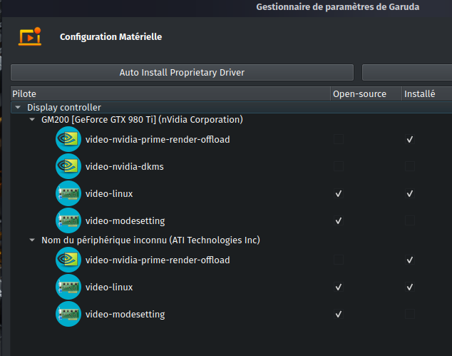

Problems:
-Second Screen not working at all, not even recognized
-Discord seems to think I have a windows update problem (minor, not Garuda related I think)
-Steam not working because nvidia driver became a mess with the update
Why every time I have problem with Garuda updates? Too old GPU? Sadness.
Already tried to garuda-update remote fix, which was the solution last time
