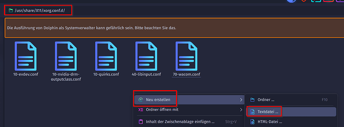

I have spent a day trying to enable an external monitor on a new ROG laptop.... i need some help.
I can see the monitor, but i cant get anything to display.
In system settings the monitor is visible.
I found a similar thread here and I think I could have success following that - but I cannot create a new file in the Xorg.conf.d folder -its greyed out
This is the output of xrandr
