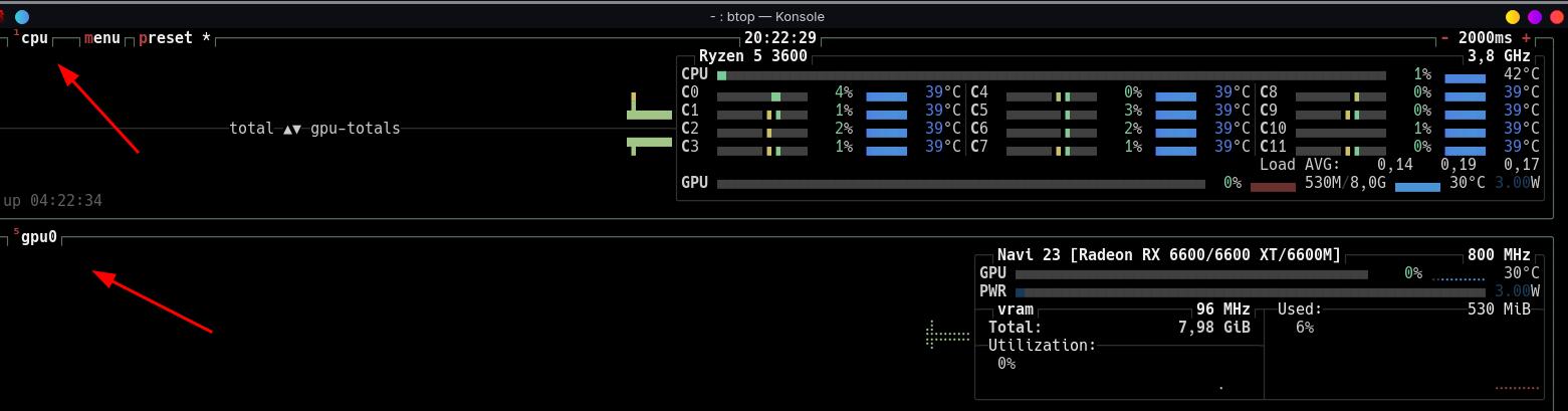

  • install btop (my mind):
    sudo pacman -S btop with command btop over terminal you start btop
    example what my btop looks like when I “just” browse + Konsole + octopi open
    (but different metal)
