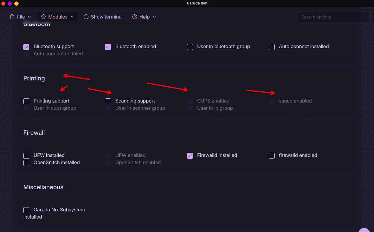

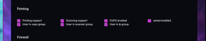

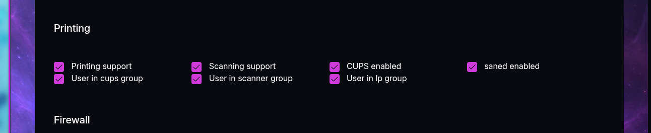

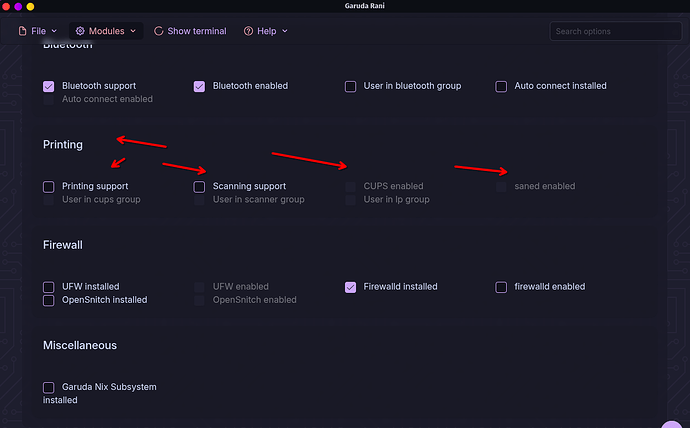

Did you checked the Rani Application too?
Hi Duke,
Yes i already have activated all these options
But thanks for your idea.
Garuda is fully updated and I as well did a reboot, but still nothing has changed. Whenever i try to print something it will show up in the printer task waiting row window , just for a moment though & fully disappear then.

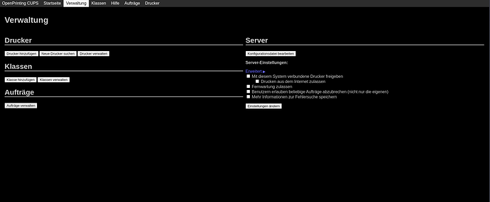

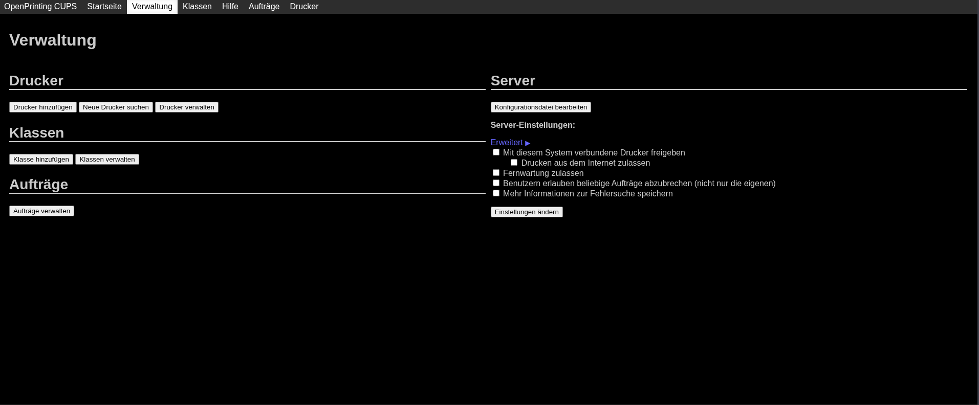

If cups service is active pls open browser → new tab http://localhost:631/admin
Do you see there the printer if you click on button printer ?
No its not set here , i guess i click add printer and do the same thing like i did in the other printer setup ?

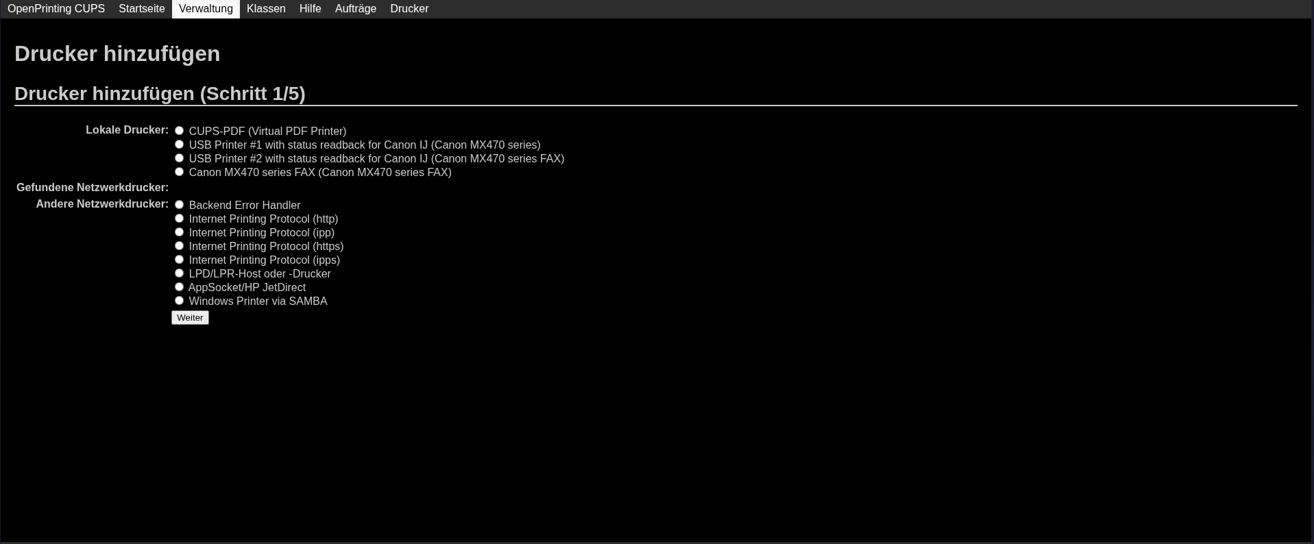

If i add new printer ( with the printer being powered on of cause) i get this screen,
which of the options should i choose there ?
You stay on cups in this tab not managed over plasma.
You should use cups to add a printer (my mind)
Select number 2 as the printer.
So i go with that first option CUPS-PDF (Virtual PDF Printer) ?
First nr 2
So this one then : USB Printer #2 with status readback for Canon IJ (Canon MX470 series FAX) ?
Do you need “Fax” over print ?
Not really no, i never used the Fax function, it has a scanner function i used quite a lot though.
lol, sorry..then not and without manaual intervention is this also not so easy if you are not familiar with the how-to.
Bur more important is: Can you print now ?

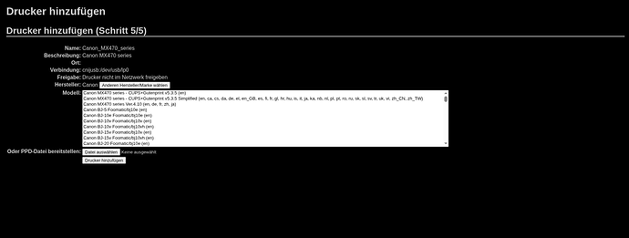

I guess i take the first Driver option here ?

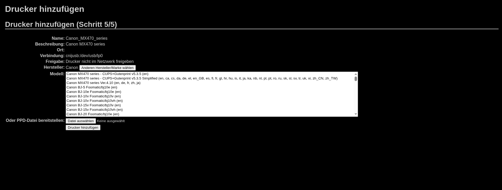

You have installed nijfilter-mx470series ver 4.10-1 you should use this driver. (option3)
Then test. (if not take nr1)
I did choose the first Driver option, sadly there is still no reaction of my printer.
