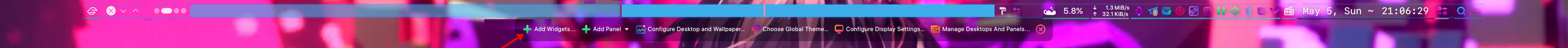

If you fresh installed kde 6 they did change “Add Widget” to not show in the R click menu. If you upgraded from 5 it should still be there.
You have to right click empty desktop - click “Enter Edit Mode”
Then it will be at the top of the screen.
I moved that bar to the bottom of the screen so it doesn’t get obscured by the top bar, but clicking on “Add Widget” does not open anything. Neither a window nor any kind of other context menu.

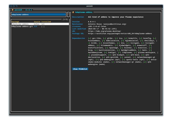

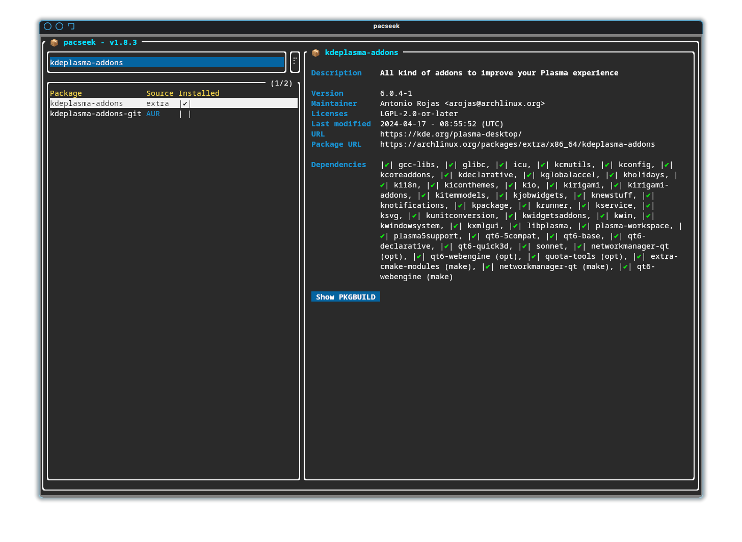

got ya the only thing I can think of your missing a package of some kind. maybe kdeplasma-addons
Should be able to get added via Octopi right? Will take a look once I can get back to my desk.
