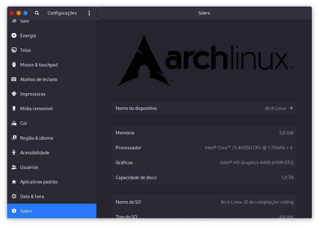

Hi,
I am a pedantic esthete. How to change it to be a logo? :slight_smile:

Post these:
ls /usr/share/pixmaps | grep -i text
ls /etc | grep -i release
grep "^LOGO=" /etc/os-release
In short...
  • Find the value of LOGO in file /etc/os-release
  • Create (if not exists) two files with names
/usr/share/pixmaps/$LOGO-text.svg
/usr/share/pixmaps/$LOGO-text-dark.svg
... obviously one is for light themes and the other for dark themes (background is dark).
I hope it works. I have no idea!!!
I just installed this on the metal to take a look and I can confirm that the logo is a broken icon for some reason.
Following Petsam's hint, I found these files:
ls /usr/share/pixmaps/ | grep -i text
.rw-r--r-- 4.5k root  6 Dec  2021  archlinux-logo-text-dark.svg
.rw-r--r-- 4.6k root  6 Dec  2021  archlinux-logo-text.svg
.rw-r--r-- 8.0k root  2 Apr 13:35  gnome-logo-text-dark.svg
.rw-r--r-- 8.0k root  2 Apr 13:35  gnome-logo-text.svg
And this clue:
LOGO=garudalinux
Copy the Gnome logo:
sudo cp /usr/share/pixmaps/gnome-logo-text.svg /usr/share/pixmaps/garudalinux-text.svg
sudo cp /usr/share/pixmaps/gnome-logo-text-dark.svg /usr/share/pixmaps/garudalinux-text-dark.svg
Presto!
Nice one Petsam, works like a charm. :blush:
Hi,
Thanks, working now.
sudo nano -w /usr/lib/os-release
LOGO=archlinux-logo
EDIT:
LOGO=garuda
:smiley:
should be now fixed for all users
added the pixmap icons to garuda icons package
