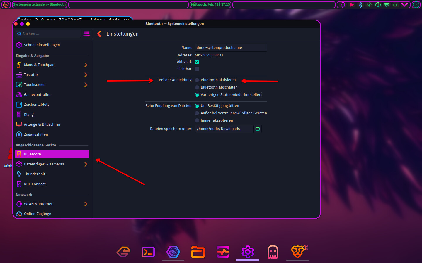

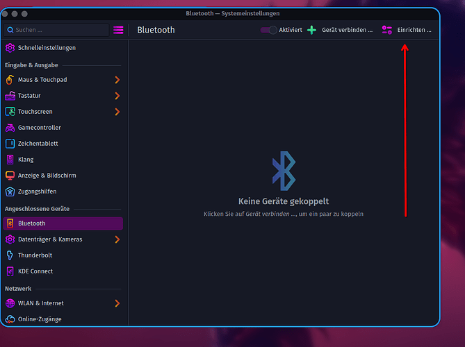

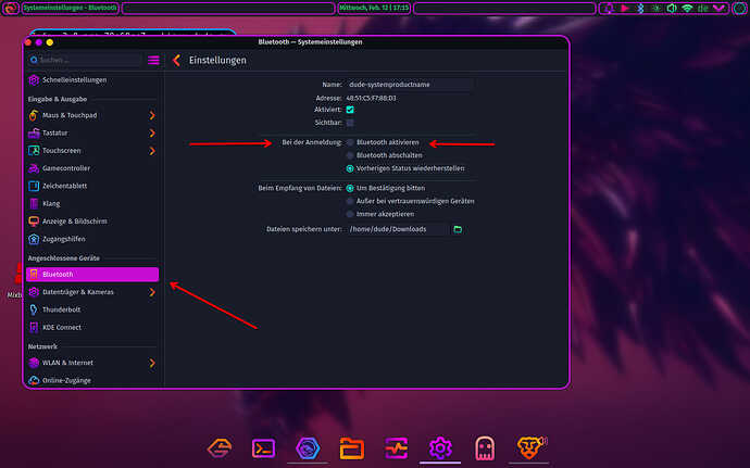

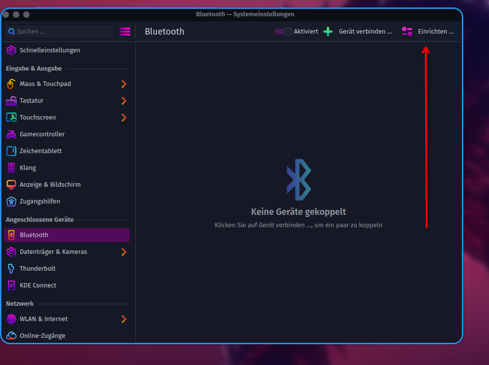

hello Azerist,
can you check your Bluetooth Settings again to watch for these Settings.
ups overread it you did already.but just for sure.
can you check this please ?
rfkill list in the Terminal and post your output please.thx
Yeah already checked that setting multiple times, it’s set on the first option “enable bluetooth”
