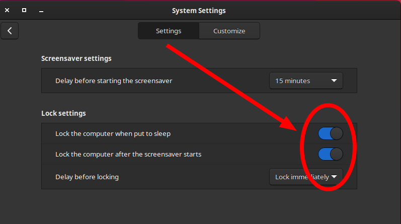

This worked! However, now the system automatically logs in, it doesn't show the password screen which is a bit of a security issue. Do you know how to fix this?
In that same file (/etc/lightdm/lightdm.conf), look for this line:
autologin-user=*username*
Delete that line, or comment it out by putting a # in front like this:
#autologin-user=*username*
They were already commented. What should i change?

It sounds like the lock screen is not enabled. Go to System Settings > Screensaver and turn on the two options related to locking the computer.
The lock screen was indeed disabled.
