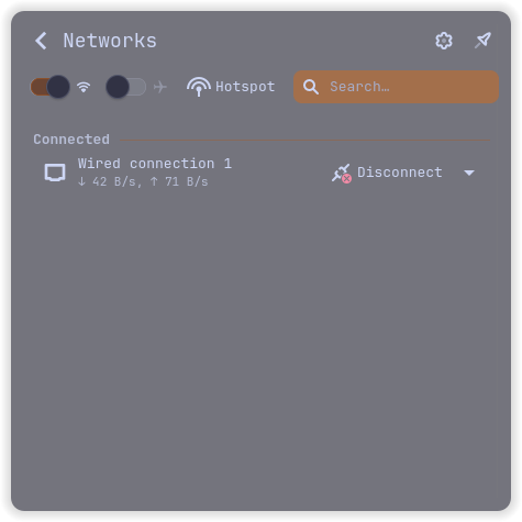

I’m having intermittent Wi-Fi issues with my Intel AX201 (non-CNVi) on Garuda/CachyOS. The Wi-Fi works for a short period after boot but then stops completely. I’m currently on the LTS kernel.
i tried all the possible solution from redddit,aur,garuda forum it worked but after 20-30 minutes the issue still persisted
Issue
  • Wi-Fi interface (wlan0) works initially but goes DOWN after 20–30 minutes.
  • ip link set wlan0 up sometimes times out.
  • lspci does not detect the Intel Wi-Fi device, even though the interface exists.

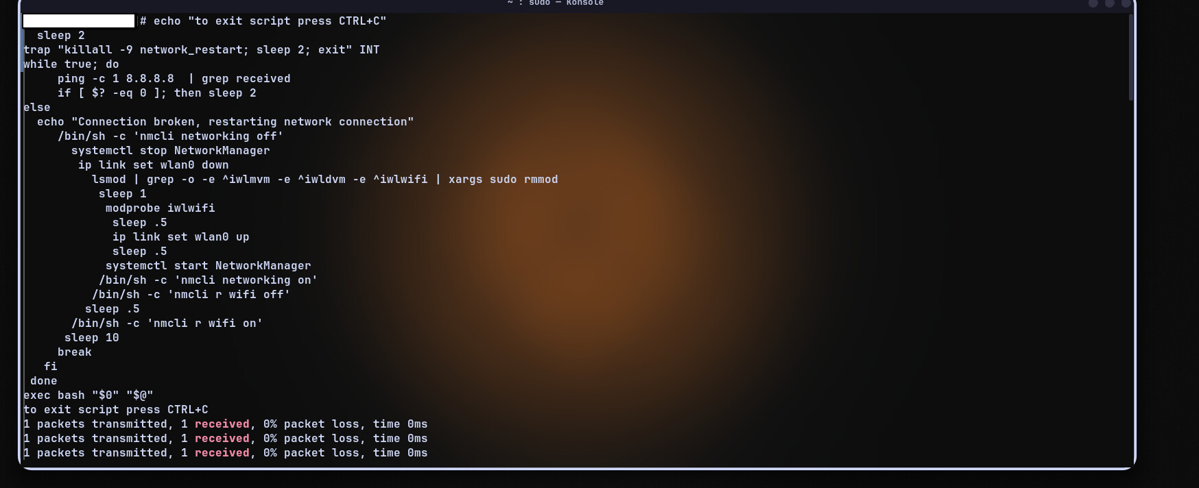

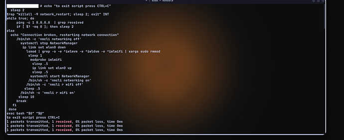

Open a new root terminal window by enterting su, and then enter your root password.
Paste the following code into your root terminal window:
echo "to exit script press CTRL+C"
  sleep 2
trap "killall -9 network_restart; sleep 2; exit" INT
while true; do
     ping -c 1 8.8.8.8  | grep received
     if [ $? -eq 0 ]; then sleep 2
else
  echo "Connection broken, restarting network connection"
     /bin/sh -c 'nmcli networking off'
       systemctl stop NetworkManager
        ip link set wlan0 down
          lsmod | grep -o -e ^iwlmvm -e ^iwldvm -e ^iwlwifi | xargs sudo rmmod
           sleep 1
            modprobe iwlwifi
             sleep .5
             sleep .5
            systemctl start NetworkManager
           /bin/sh -c 'nmcli networking on'
          /bin/sh -c 'nmcli r wifi off'
         sleep .5
       /bin/sh -c 'nmcli r wifi on'
      sleep 10
     break
   fi
 done
exec bash "$0" "$@"
Let the script run continuously to see if your connection remains stable.

Disconnect usb tethering then run the script.
Best to create the /usr/local/sbin/network_restart.sh script, then execute the script.
See my above edits for the script.

Please never post pictures of terminal outputs, only post code.
alright i will try your above script after a restart or kernel reinstall since that seems to give me temproary access to wifi for atleast 20 minutes.
my bad i totally forgot
Be sure to disconnect usb tethering before running the script.
1 packets transmitted, 1 received, 0% packet loss, time 0ms
1 packets transmitted, 0 received, 100% packet loss, time 0ms
ping: connect: Network is unreachable
RTNETLINK answers: Operation not permitted
[sudo] password for mak:
modprobe: ERROR: could not insert 'iwlwifi': Operation not permitted
Cannot find device "wlan0"
rmmod: ERROR: missing module name.
^Cnetwork_restart: no process found
worked for an hour and it stopped
i just bought a usb dongle just in case, after plugging it in everything works as intended.
is this issue related to kernel or my wifi card ? ( i guess it’s related to my wifi card ? )
