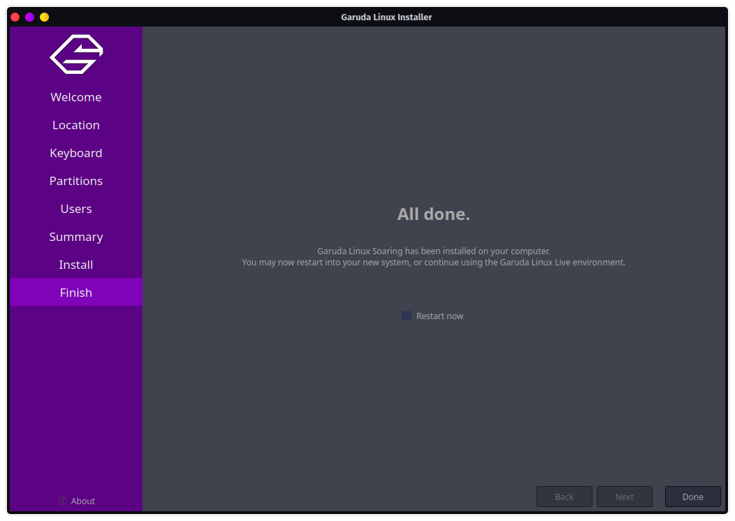

I’m unable to finish installation, I’m always getting popup window
Error
Installation Failed
Bootloader installation error
Details:
The bootloader could not be installed.
The installation command
grub-install --target=x86_64-efi --efi-directory=/boot/efi – bootloader-id=Garuda --force returned error code 1.
Disk is primary and empty.

Disk have created partitions, but even if I do quick format and start a new installation, it does not change anything.
Are you sure legacy mode has not been enabled? I ask because of this:
Double-check in the BIOS menu that legacy mode is disabled.
Which disk are you choosing as the installation target? Are you attempting a full wipe/install, or something else?
Yes, I'm running OS in UEFI mode.
First I tried following this.:
Then I also tried full/wipe/install and I'm trying to install it only on.:
Model: ADATA SX8200PNP (nvme)
Disk /dev/nvme0n1: 512GB
Results were only the same.
Hmm, something about your UEFI does not seem to be handling this correctly. Check if you have a CSM option in the BIOS menu and disable it.
There is a switch in BIOS where you can choose CSM or UEFI, it's been enabled (by default too ) as UEFI.
I installed around 15 distros in last 3 days and only Garuda have this issue.
It appears something is tricking your UEFI into using legacy mode, so the installation fails because it is attempting to use UEFI mode. My hunch is a setting in your BIOS menu is responsible, although I obviously cannot see what you have in there. Another consideration would be to try a different USB stick.
Use ventoy.net , use normal boot to boot the ISO.
I'll try live boot with other distros and let you know if efibootmgr reports something different. Thanks for the checking
@SGS That's the way I'm installing any distro including Garuda.
Ok, with other distros it also reported same issue >
EFI variables are not supported on this system.
Then I thought of one last thing to try, I reset the bios settings.
╰─λ efibootmgr -v
BootCurrent: 0009
Timeout: 1 seconds
BootOrder: 0009,000A
Boot0005 UEFI OS HD(1,GPT,acbe5d56-8082-3a43-a8b2-47bb835bad46,0x1000,0x1f4000)/File(\EFI\BOOT\BOOTX64.EFI)0000424f
dp: 04 01 2a 00 01 00 00 00 00 10 00 00 00 00 00 00 00 40 1f 00 00 00 00 00 56 5d be ac 82 80 43 3a a8 b2 47 bb 83 5b ad 46 02 02 / 04 04 30 00 5c 00 45 00 46 00 49 00 5c 00 42 00 4f 00 4f 00 54 00 5c 00 42 00 4f 00 4f 00 54 00 58 00 36 00 34 00 2e 00 45 00 46 00 49 00 00 00 / 7f ff 04 00
data: 00 00 42 4f
Boot0009* UEFI OS HD(2,MBR,0x29a507b,0x1d066800,0x10000)/File(\EFI\BOOT\BOOTX64.EFI)0000424f
dp: 04 01 2a 00 02 00 00 00 00 68 06 1d 00 00 00 00 00 00 01 00 00 00 00 00 7b 50 9a 02 00 00 00 00 00 00 00 00 00 00 00 00 01 01 / 04 04 30 00 5c 00 45 00 46 00 49 00 5c 00 42 00 4f 00 4f 00 54 00 5c 00 42 00 4f 00 4f 00 54 00 58 00 36 00 34 00 2e 00 45 00 46 00 49 00 00 00 / 7f ff 04 00
data: 00 00 42 4f
Boot000A* ubuntu HD(1,GPT,06457706-b697-4a4f-82ca-4267e33bf0d3,0x800,0x100000)/File(\EFI\UBUNTU\SHIMX64.EFI)0000424f
dp: 04 01 2a 00 01 00 00 00 00 08 00 00 00 00 00 00 00 00 10 00 00 00 00 00 06 77 45 06 97 b6 4f 4a 82 ca 42 67 e3 3b f0 d3 02 02 / 04 04 34 00 5c 00 45 00 46 00 49 00 5c 00 55 00 42 00 55 00 4e 00 54 00 55 00 5c 00 53 00 48 00 49 00 4d 00 58 00 36 00 34 00 2e 00 45 00 46 00 49 00 00 00 / 7f ff 04 00
data: 00 00 42 4f
I will let you know if installation finish normally now
Finally, installation finished. I'm not sure what settings make in happen in BIOS (And no, it was set to UEFI mode before resetting bios just like after reset).
Thanks again for the assistance guys!
